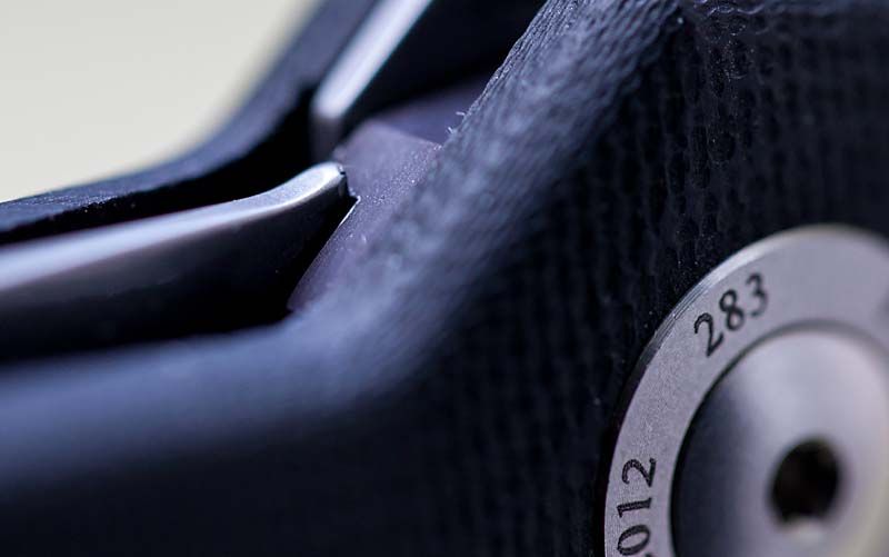

Thank YOU sir, and one other point about the lock bar, I had noticed in the video and of course now that it's here, you will see that the very tip of the lock bar has a nub sticking up, my thinking is that is for future times when and if there is any lock wear, that small bit will then be striking the tang to help keep it locked up solid.
G2
edited to add this photo of the lock bar tip

Thanks for your photo. In this case, then actual contact point of the lockbar to the blade tang might not change even if the lockbar is 'pulled back' by the tab, in respective to the blade tang. It then doesn't make the support point narrower.

The more I look at it in relation to the rest of the liner, I think it was just happenstance that there is a nub sticking up, where it's been cut by an EDM machine, you can see that if it hadn't been cut the slope upwards would match with the rest of the liner, so my 'guess' was just that I think, a guess that it was engineered to be an extra catch for lock bar contact...
Just picture that lock bar pressed back against the scale and you can see how it will match up with the rest of the liner.

Sorry for not being clear. I was not talking about the nub, but the extra lockbar area where upon rotating it back, will match exactly with the tang. In this case, there's no reduction of torque point of the lockbar-tang contact. It seems to always be on the furthest part of the tang (against pivot). To me, that's smart engineering :D.
