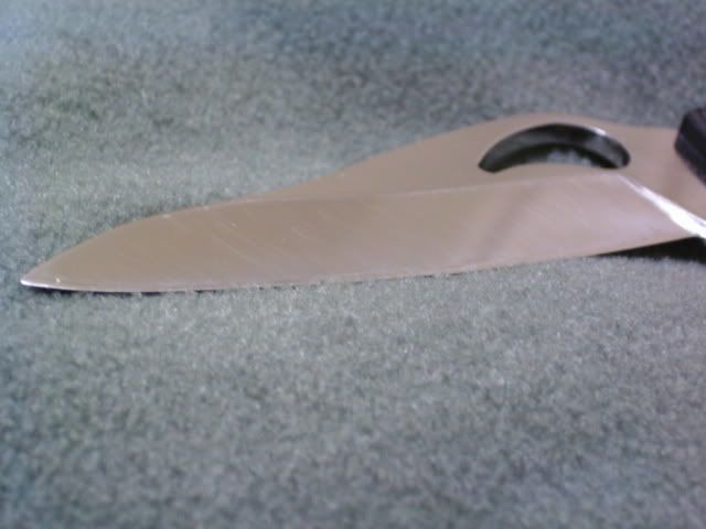

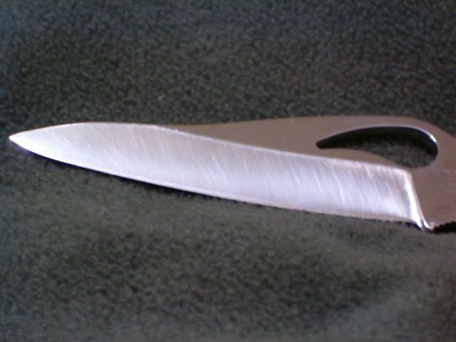

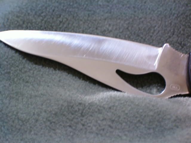

After taking the time to convex my Cara Cara I too got the bug to do some work a bit more drastic. Here are the results. In the first pic you can see some of the hollow at the back of the blade, I am annoyed by it, but got so tired of hand grinding, I just said to heck with the cosmetic aspect.
In the second and third pics you can see how much was removed to get the blade flattened out nicely. Here is a link to a stock Cara Cara for visual comparison:

At first I tried it as it was, but man, that paper thin edge wouldn't hold up at all, so I used some ceramic rods to set a small secondary, and now it cuts like crazy, and is quite durable.
In the 3rd pic you can see how far back the flat moved from the tip, compared to the stock blade. It was work to do manually, but when slicing, and sharpening, well worth it.
