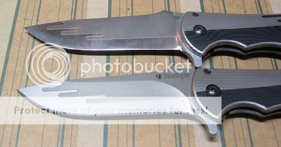

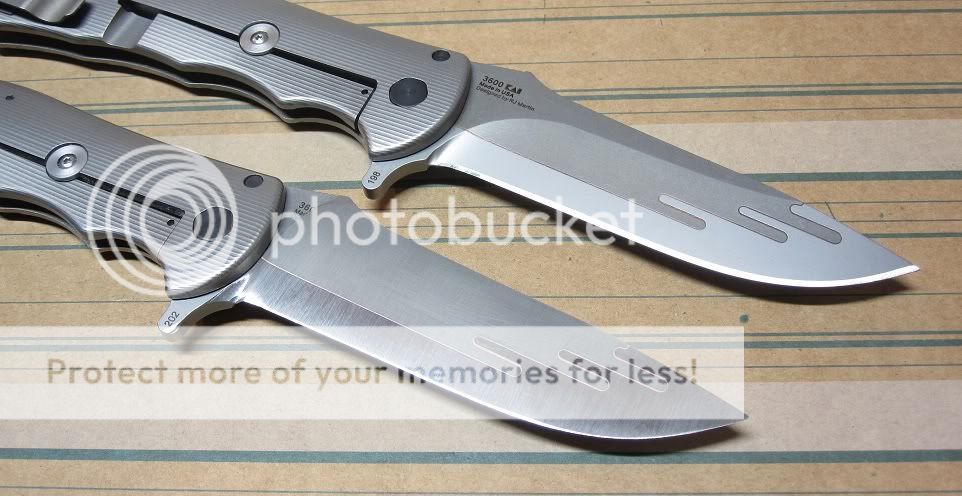

All this waiting for the Tilt is making me hungry for some high end flipper with amazing blade geometry. So I decided to upgrade my (current) favorite knife.

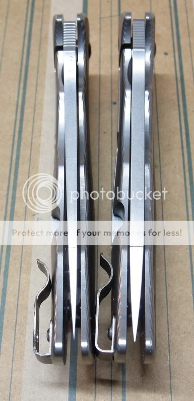

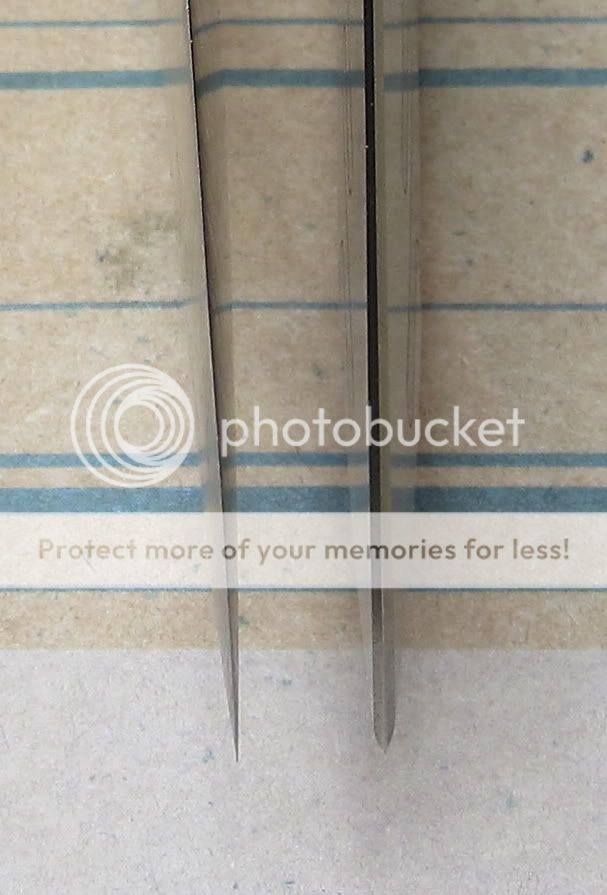

It was a relatively quick and dirty job, somewhat of an experiment, but I am quite happy with the results. Along with the thinned out blade comes weight loss of almost half an ounce (5.2oz to 4.8).
Unfortunately the lighter blade doesn't flip nearly as well, but that's a minor complaint in light of the massive improvement in cutting performance.

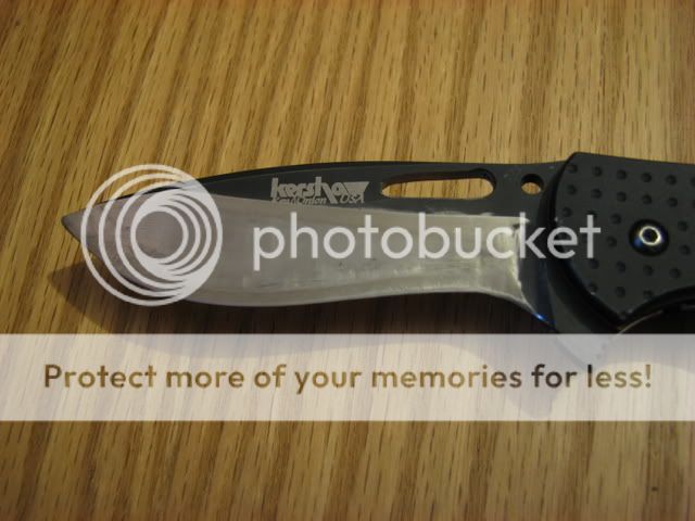

You killed a Boa AND an Offset too? :(
Actually I made the Boa "better", it cuts really nicely. The Offset is the only grinding job I've botched up.
