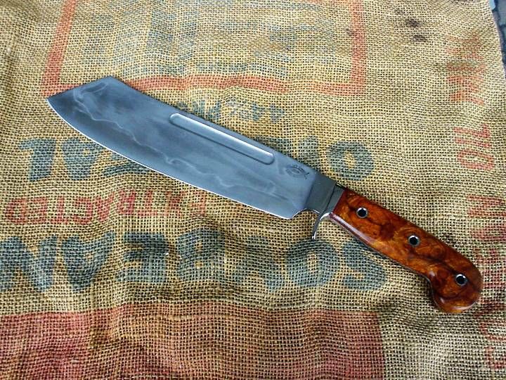

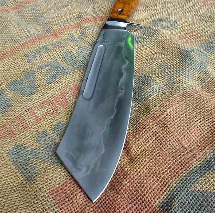

The first is a forged W-2 Chopper with hamon. 416 SS guard, Ironwood w/.015 red liner and 5/16" SS tube handle pins.

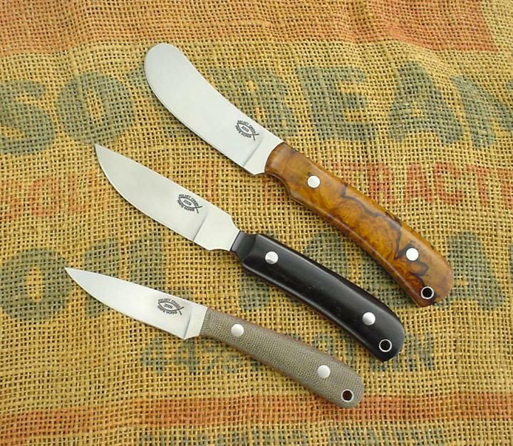

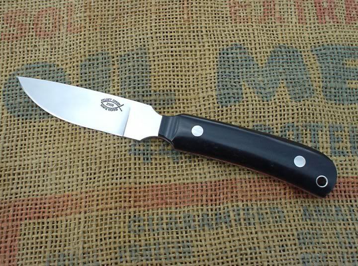

Some Loveless Style Hunters. First ones are Drop Point Hunters w/ 4" blades, CPM154, tapered tang, 416 SS & Ironwood w/.015 red liner
