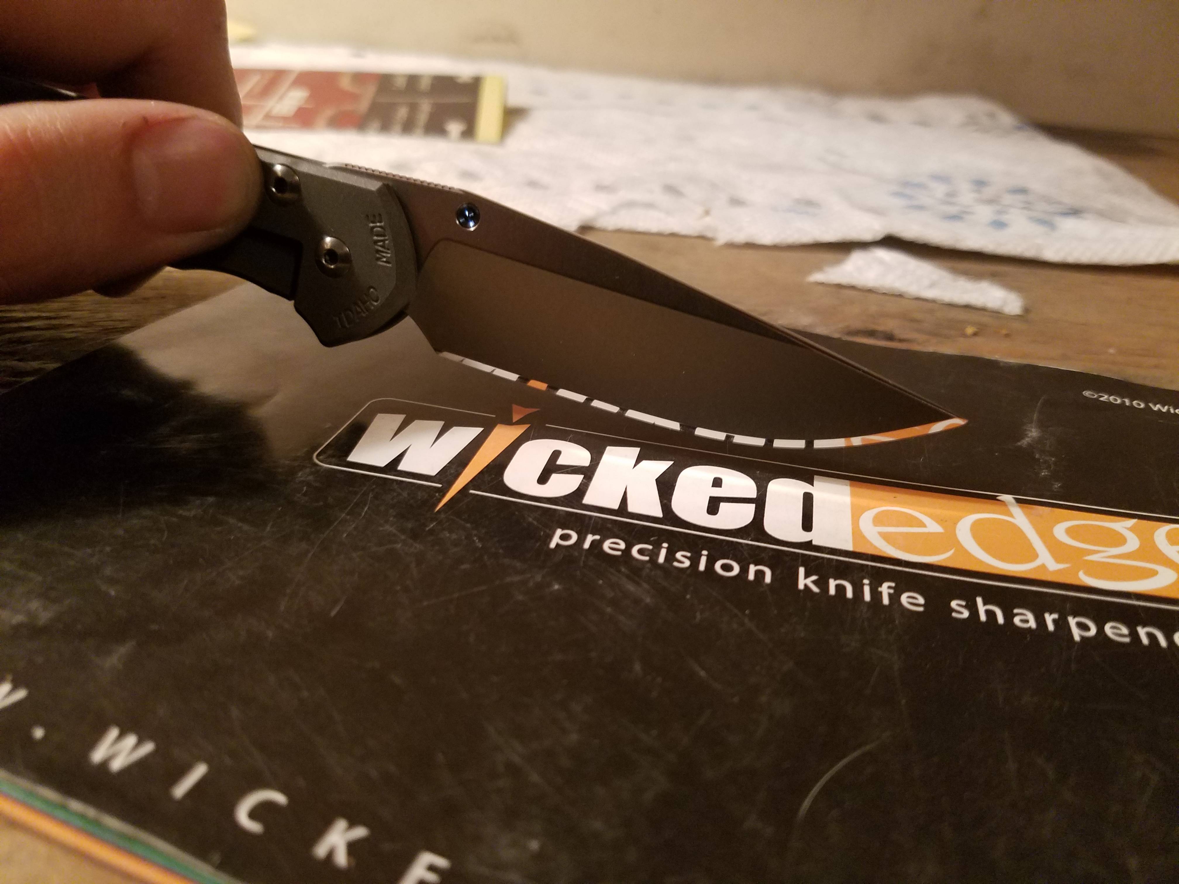

Hey Bobbie, I'm also new at the WE system and haven't achieved a mirror edge on any one of the 4 folders and 2 chefs knives so far like your Sebby. Maybe I need to spend more time with each grit from 800 on up?

I'm using 50-1000, 3 micron diamond, 1200/1600 ceramic, until i get my choseras I'm using 2000, 2500, 3000 grit sand paper on platten paddles, then sometimes i start at 14/10 micron strop, others 5/3.5 strop, then 1, .5, .25 micron diamond sprays, and finish on .1 lapping film.
You should get the 1200/1600 ceramic and the 5/3.5 strop and you should have a mirror finish...just remove the scratches from each previous grit b4 moving on.
Also you should be moving your arms in to a lower angle to strop, not out to a higher angle.
Keep in mind if your stones are new they will be cutting overly aggressive for a time, as soon as they really break in (15-20 knives on avg) is when you'll really see the edge really take a mirror. Try using a little lighter pressure letting the stone do the work and ease up on your finishing stokes with each grit. You want to be sure you are removing all of the scratch pattern from the previous grit before laying a new scratch pattern and moving to the next grit.
