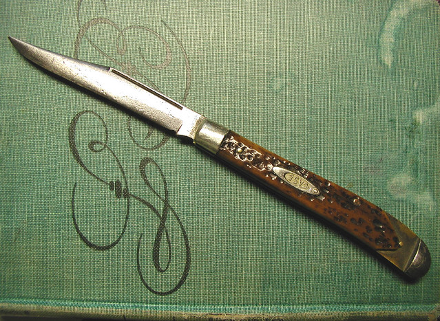

Here's an early Case Cattleman <?. They seem to have been made for only a couple of years and were made by Case, Platt or possibly Napanoch. Is there any way of telling by the mark who made it?
I'm posting this on Bernards forum as well although he is very rarely there lately.

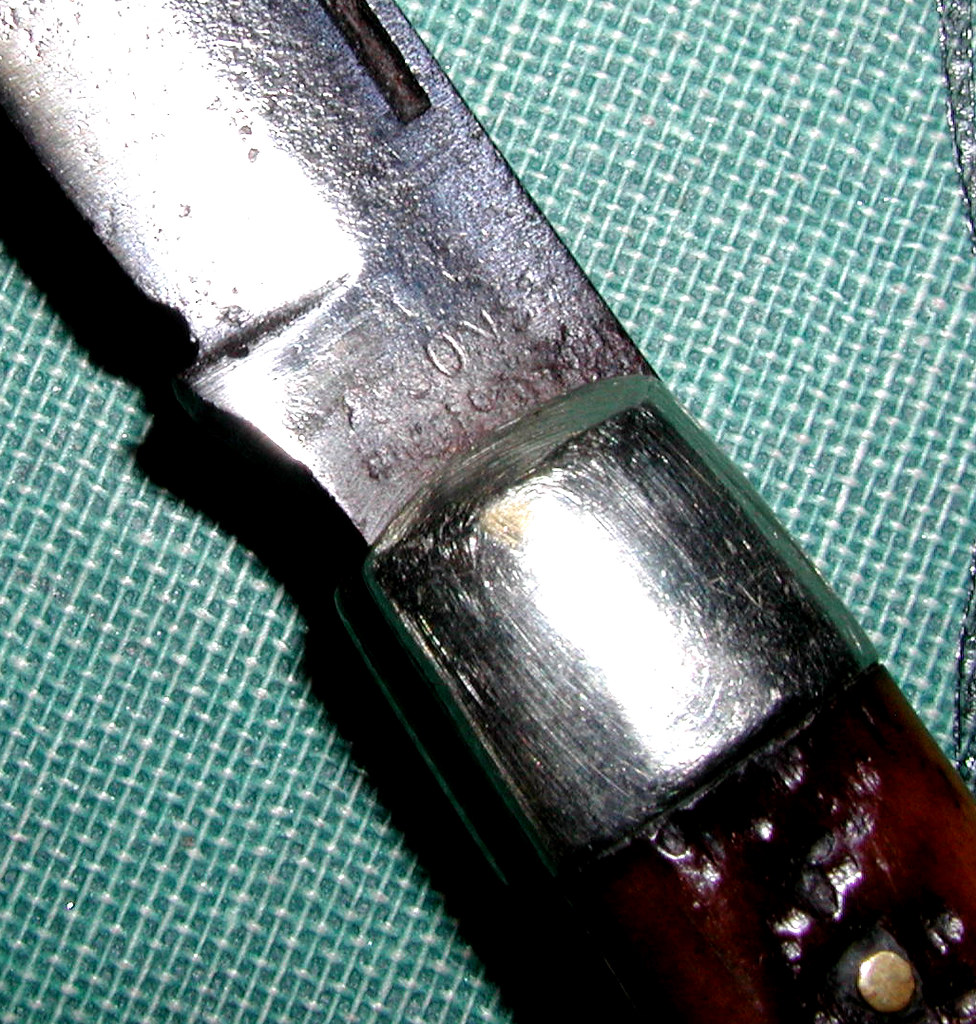

Added a pic of the mark on the broken blade, there is no wear on the tang so the mark is nice and sharp.
Best regards
Robin

What a treasure, Robin!! I have an old wreck with the same stamp, but its so badly worn away, so it's hard to tell exactly. I will wait to see what the masters say concerning your question.
Looks like it might have been a reddish bone at one time, Robin.

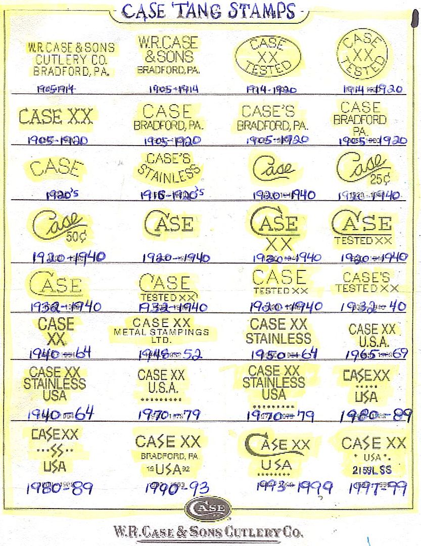

If it is around 3 5/8" long, it is probably a 6345. You may have already seen this Tang chart:
In this pic, the bottom knife is from the same era, I believe. It has early rogers bone, and a shield, but the blades might tell you a bit.

Thanks Charlie It is 3 5/8ths and sure looks like the 6345. The broken stub looks like a pen blade to me but could have been a narrow sheepsfoot as well. I have not found a Case chart with the W.R. Case and Son(singular) mark from Little Valley NY. So far it seems that they opened in 1901 and by 1905 they were in Bradford. Thanks again for the pattern.

The more I look at mind its probably a Bradford. I hope we see more tang stamps like yours in this thread for comparison. I just love these old knives and yours is something special, my friend!!
Hi Bro
If it's marked Sons then it's Bradford, I Think. So look to see if there's an s. I'm getting confused reading bits and pieces in a lot of places. Apparantly the W.R. Case and son knives are from little valley. W.R. Case and sons are from Bradford. I think the two marks are different wings of the family. BUT don't quote me. :D Missed your pics until now. That's a great slimline. It kind of looks like Bradford to me.

Just looked at it under the dissecting microscope and there is definitely the bottom portion of the "S" in SONS. Its almost certainly Bradford as well. The history is so interesting with the Case Brothers.

This description is found on page 156 of the 'Official Price Guide to Collector Knives', Fourteenth Edition (2004) by C. Houston Price:
"(...) Through the support and financial assistance from his father, "Russ" Case founded a knife brokerage firm in Little Valley, New York, in 1902. In an effort to have customers perceive his new business as being well-established, he not only used his grandfather's (Job R. Case) picture in the company's advertising, but he also used his father's name in naming the company W. R. Case & Son.
Russ Case purchased knives for his brokerage business on contract from Platts Brothers Cutlery Co., Cattaraugus Cutlery Co. and others. Consequently, there were many pattern variations during this 1902-1905 period preceding his own factory."
This appears to imply that Russ Case's company wasn't actually making these 'Little Valley' knives, as he had no factory prior to moving to Bradford, PA., but instead had them made under contract. On that same page in the guide, there are various tang stamps shown, one of which appears to match the stamp shown in your pics.
Don't know if this adds any to what you've already discovered, but I hope it's helpful. Great find, on that knife, BTW. :thumbup:
