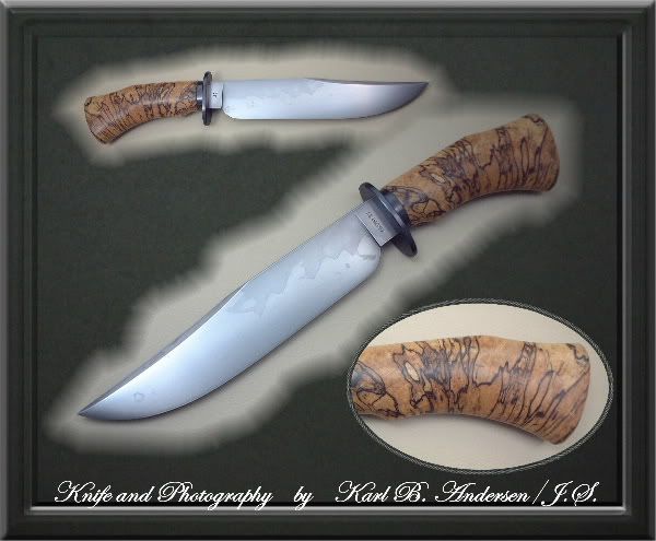

I just love using this end-grain spalted maple from our ol' friend Larry Bailey.
Once it is stabilized it just turns into a solid piece of plastic.
The mild steel take-down fittings were hot blued and the W2 blade was clayed for a nice hamon.
(Will be on my table in Atlanta)
8 1/8" blade and 13 1/4" overall.
Excellent looking knife. The maple also adds so much character. Goes nicely with the hamon too.
Karl, That looks like some rotten wood you need to get rid of. I'll take it off your hands. Fine looking knife as usual!
Killer. Am I seeing a slightly different handle shape here - maybe a little more drop?
Roger
Oh, I like that one a lot:thumbup:.
Beautiful piece. I believe that's the nicest piece of spalted maple I've seen on a knife handle.
