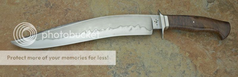

Just finished this one ( its 1 of my 5 for judging this year for my JS )

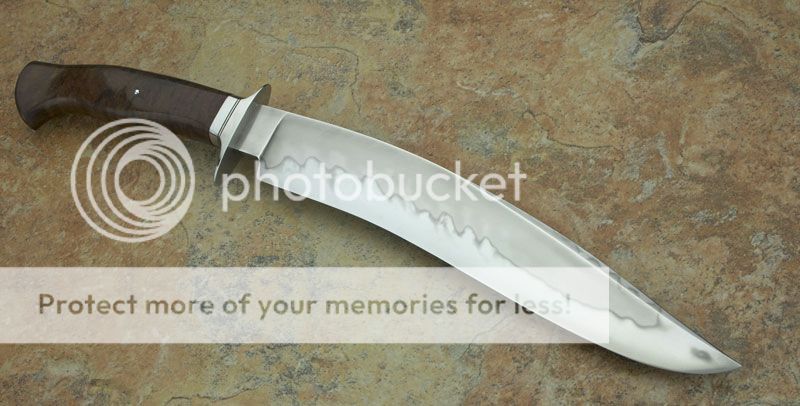

SPECS W2 with hamon, There is a lot of activity going on here, just cant capture it with my limited skills.:eek:
BL 10", 252mm. OAL 16 1/4",415mm.
Thickness at Ricasso .2365, 6mm

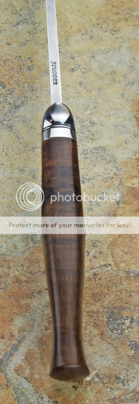

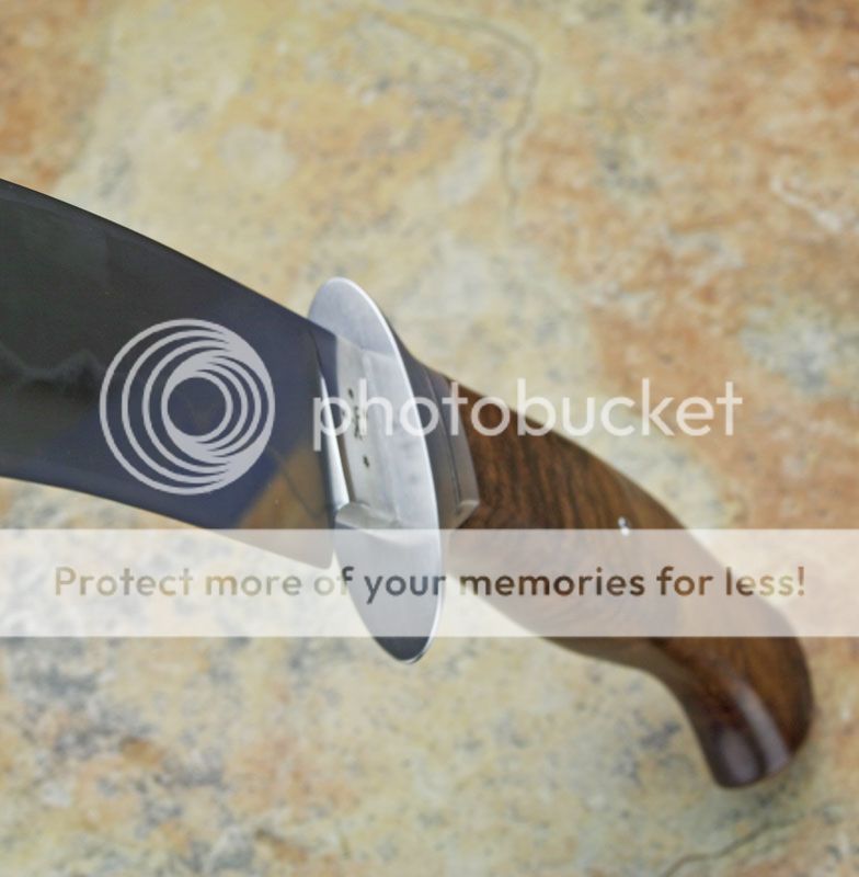

416 guard with fibre spacers, domed pin. Figured Gidgee handle.
Just have to make some pants for it and a sharpen.
Thanks for looking and your comments are most welcome.
Cheers Keith

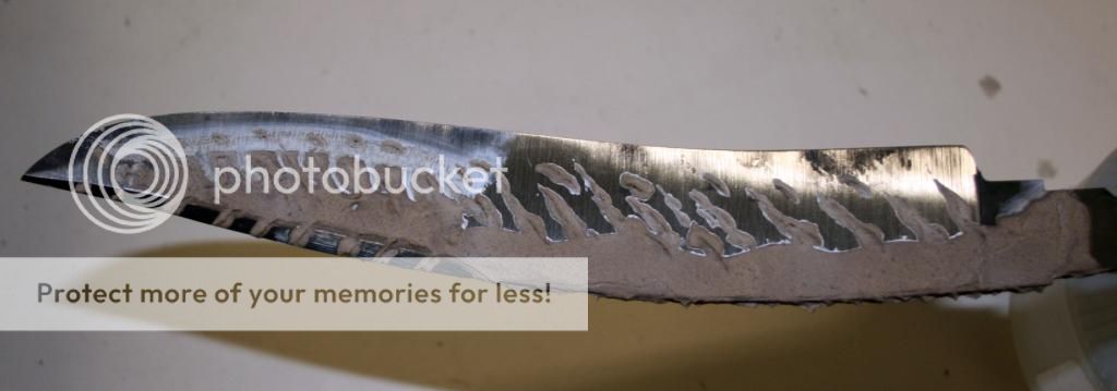

It's always cool to see the clay layout and then the finished hamon. Yours followed the clay pretty darned close. In any case, an exceptional knife!

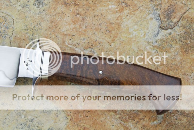

Very clean and well executed. Handle looks nice from both visual and ergonomical perspectives.
I'm not a fan of the curved blade spine, but that's just a personal opinion. :thumbup::thumbup:
Excellent! I'd love to see that hamon in person, I bet there's cool stuff in there. Nice blade shape!
that there is a reaper of souls.
That's a seriously nice knife Keith!! I love the hamon that you've got going on there brother, VERY well done! That blade profile is almost Kukri-like. LOST of chopping power in that design. To borrow a phrase from my buddy Joe P, I bet that sucker hits like a razor sharp lead pipe! Can't wait to see it in Atlanta, and good luck on the test!

While it is well finished and shaped, that curve would keep me from even looking at it for any length of time....not a fan.

I am a fan of the curved spine or drop point Bowie and thoroughly enjoy seeing this one.

Really like what you've done with the handle, sweet piece of Gidgee, domed pin and the guard looks just right.

Like the bit of clay at the tip!
