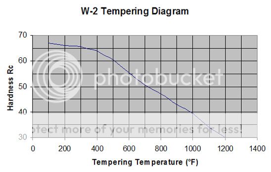

Could someone point me to a reputable one? I managed to find 2 charts, but both were vastly different.
I'm currently building 2 of the largest knives I've ever done from Aldos W2. Its 1/4" stock, blades are about 1 7\8" at the widest from edge to spine, just under 10" blade. They're going to be a fighter style sub hilt bowie. Now please correct me if I'm wrong but, for a knife of this size and heft, I should be looking at a 57-58rc? Either way, I'd just like to see a chart so I know where to start.
Thanks so much
57-58 Rc with W2? No way. That is a waster of material . I never send anything out of my shop at less than 60 Rc, even big choppers. One of the first W2 choppers that I ever sold, a 10 x 1 3/4 by around 1/4 thought hardened blade at around 61Rc, went to a Marine colonel to replace a torch heated, edge quenched 5160 chopper at 58Rc made by what was a fairly well known shop. The 5160 blade chipped a bit while cutting up a cooked goat or sheep for a party in Iraq. He abused the W2 knife on trees and bushes in his yard and no chips, no rolls and no flat spots.
This looks pretty accurate from my experience.... (and agree that W2 should be at least 60-61)
Interesting. I have seen videos on W2 blades tested at 65rc but, was just curious. So I'll temper at 500 for around 60rc. Thanks guys.
Those results seem to be fairly typical in my experience. I have used a low as 375 for a kitchen knife, but mostly 425-450 for other blades. Mme are that you give it a nice little soak at some austenizing temp below 1500. A couple of folks here have settled on temps around 1465 or so for max performance. A bit lower can get you a more active hamon.
I usually use 450F for a Rc 60-61 result.
I use 450 as well unless its extremely thin and then I push it up 25 degrees. W2 is noted for producing very keen thin edges that hold up well. Remember to draw the tang and ricasso area especially if its going to take some abuse.
