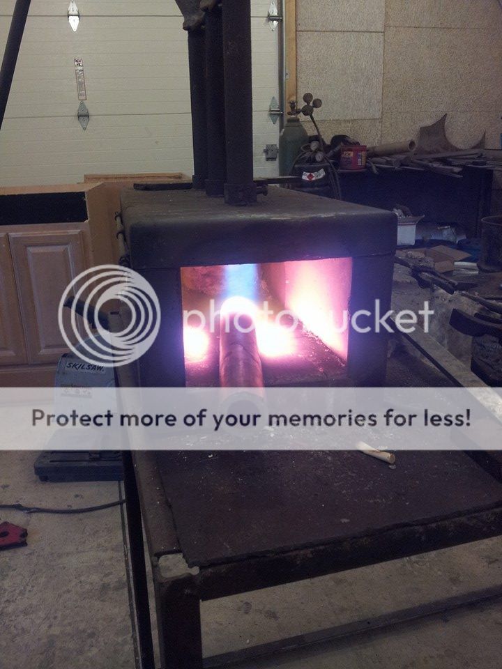

with all the Kepharts i have been doing and with the up coming Ohio Classic Knife Show
i decided i needed to change it up a bit for my sanity
so i started off with a bar of 1X 1 1/2 W2
(yes that is a subliminal message)

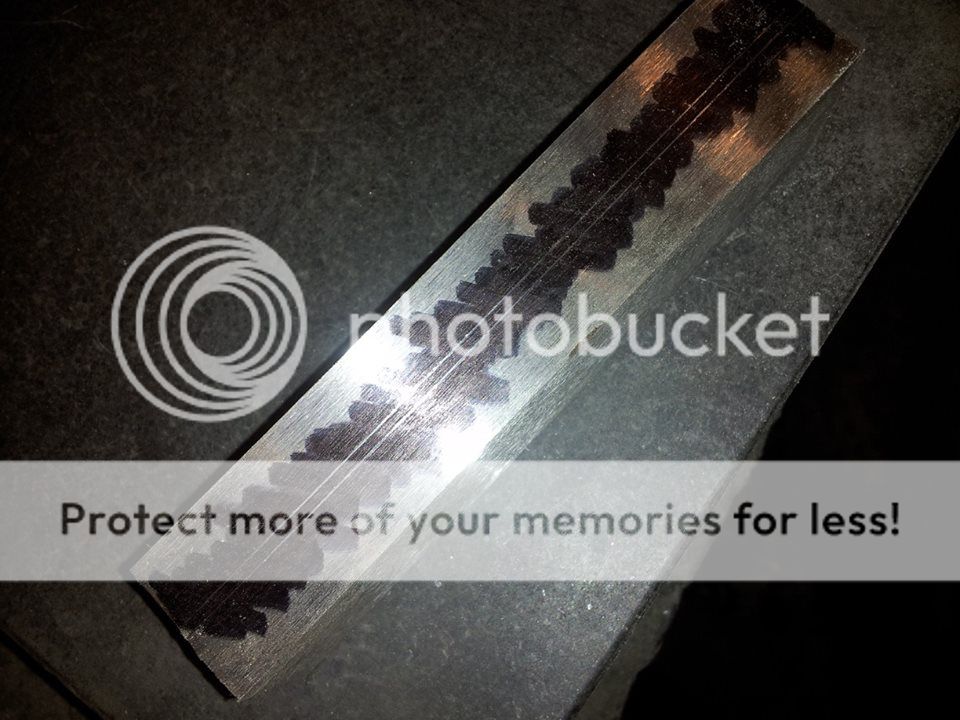

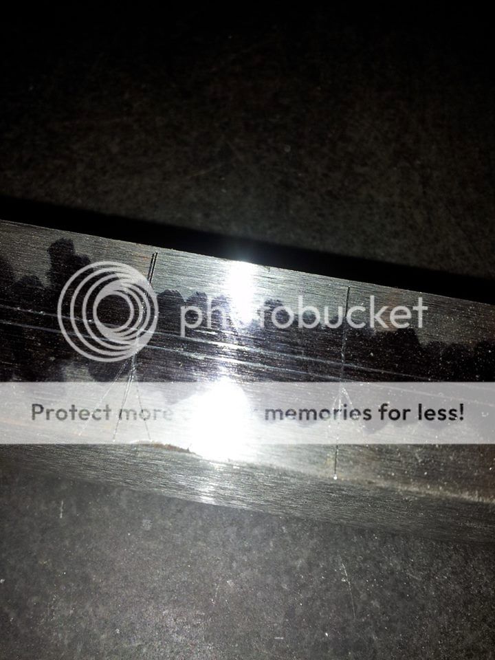

marked a center line
marked the ends of the slot
drilled holes for the slot

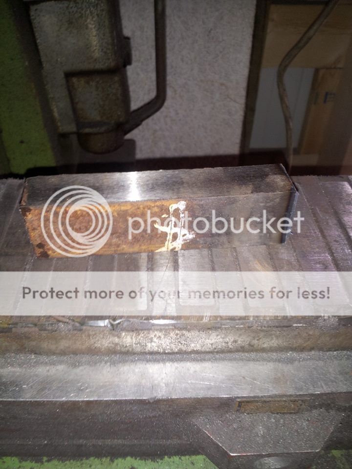

milled a 1/4 inch slot for the drift

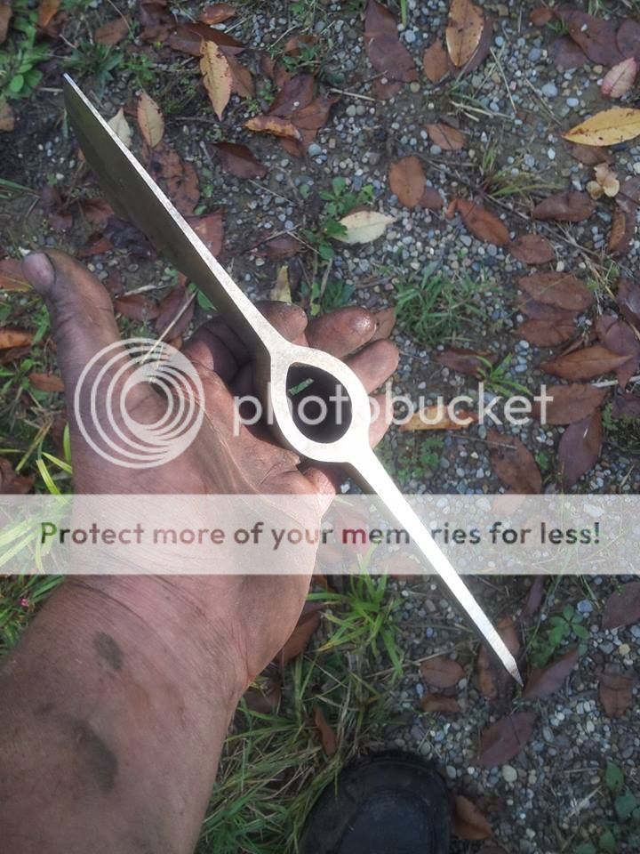

forged the spike and bit first
then i drifted the hole, yes i know its a fugly forging but its my first one
after grinding away all that wasent hawk
im happy every thing is centered
thanks for looking ill add more as i get it finished
Cool wip what wood are you standing it on ? I think Zebrano or some type of striped woods look great under these .
it is looking nice indeed. I have to say the spike is a lot longer than I'm used to seeing, which is not to say I don't like it.

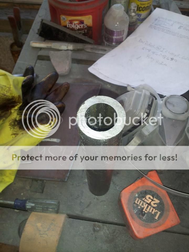

i needed to open up the eye just a little bit and the bet way i could think of was to get a piece of heavy wall pipe and drift it too
it needed about another inch deeper
first the pipe
and this is where the phone went for a swim
