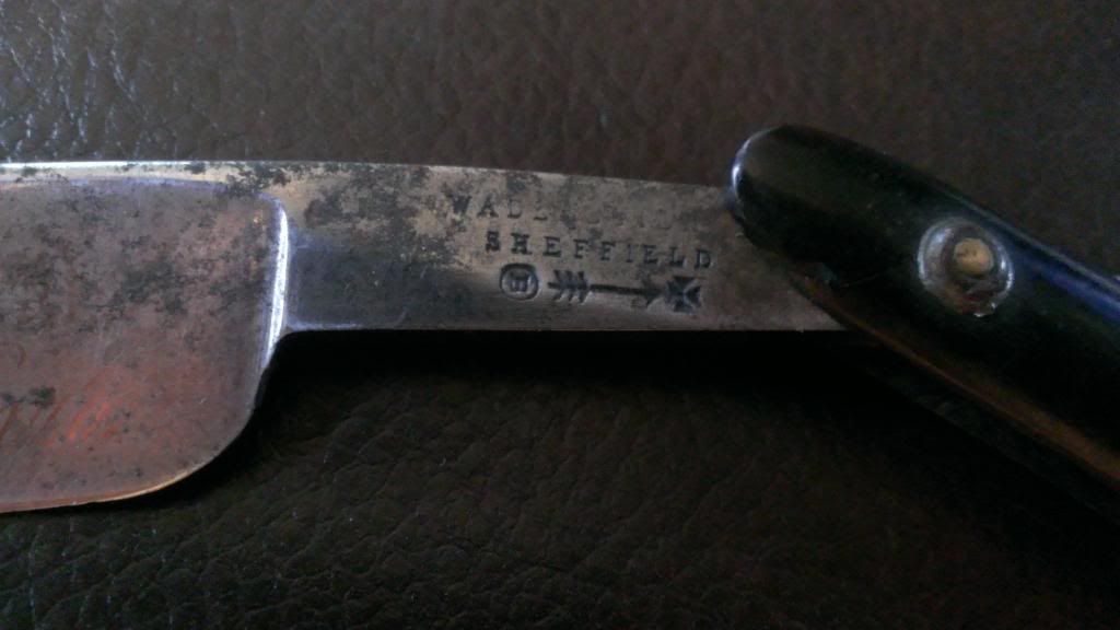

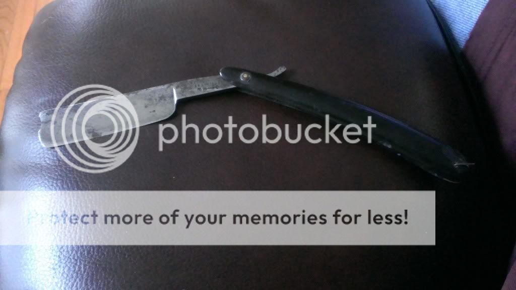

I bought this straight razor at an antique store for 10 bucks and I'm pretty sure that it reads "Wade & Butcher Celebrated Fine India Steel Razor". Now it has some active rust on it and I was curious to whether or not I should sand the rust off? By doing this the etching will pretty much be gone or illegible and it would be a shame if it turns out to be something unique.
Here are some pic's
My first few straights looked like that. I rubbed them with steel wool to remove any high spots or rough areas and then oiled liberally. A couple days later I would wipe it down again with scotchbrite. The it was time to sharpen and enjoy a lovely vintage straight.

This one isn't all that bad, I'll have to try the steel wool. Not sure if I want to leave the patina or not though.
You got a really nice one there! Wade and Butchers have a reputation for being great razors. I would just clean it up, re-pin the back and get it honed by a pro. Most of the pro honemeisters could probably take care of that pin as well if you wanted. As far as the patina, I would leave it, but it all depends on what it takes to clean the rust off. I would start really gentle, and only go to the sandpaper if it wasn't enough. a bit of pitting isn't that bad, as long as you can keep the active rust from setting in again, which shouldn't be all that hard.
I did start with steel wool, then a cleaning compound. But there was some pretty deep pitting near the edge and I couldn't have that. So I sanded it starting with 60 and I'll finish the rest tomorrow to a polish. Then I'll send it to a pro to do the edge, any recommendations on pro's here on BladeForums?

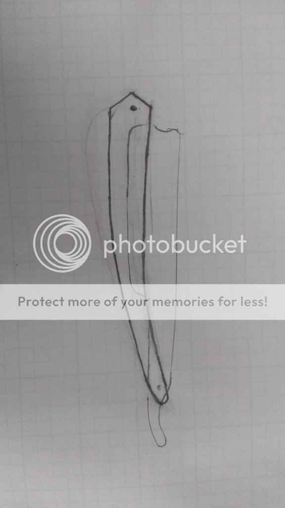

As for the handle, I plan on making my own. The handle it came with was definitely a cheap replacement and deserves better. I plan on making one out of foreign wood, maybe bocote. I may even go for something I've never tried like brass or aluminum.

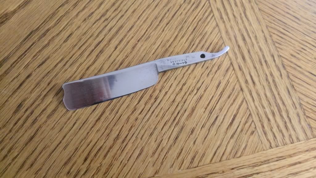

Alright got the blade cleaned up to about a 1200 grit
Also got my handle design lay out and I found a piece of 1/8" Bocote in my garage
