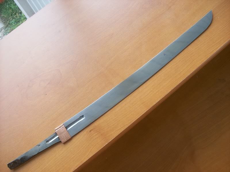

Here is a waki I have forged for a customer. it has about 2000 layers. I am still sanding, not yet etched and so on. just finished the habaki, all copper.
will post more as progress continues.
thanks for looking

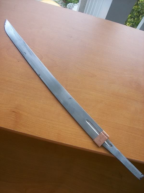

Okay, Here Are The Pictures Of The Waki. I Have Not Yet Etched It And Hand Polishing. I Done The Habaki Last Night. Hope You Like The Fullers.
I Am Doing The Shisaya Now. I Am Going With An Extra Curly Maple With Dark Brown Cocobolo As Ends To The Handle And The Scabbard.

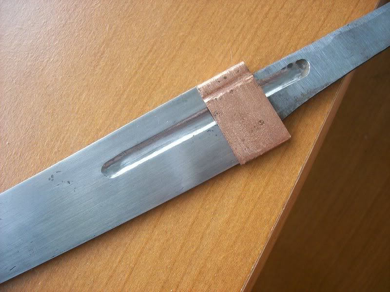

I ran it under since the habaki has a partial islet inside the habaki that stops the slide in progression.....technically, wanted to try something a little different.......lol....
the core is tamahagame with the outer layers folded cable damascus.... I forged the cable with 5 layers then folded it 4 times. the pattern is a wavy itame, I am not a sword know it all, just know how to make them so my terminology may be off.

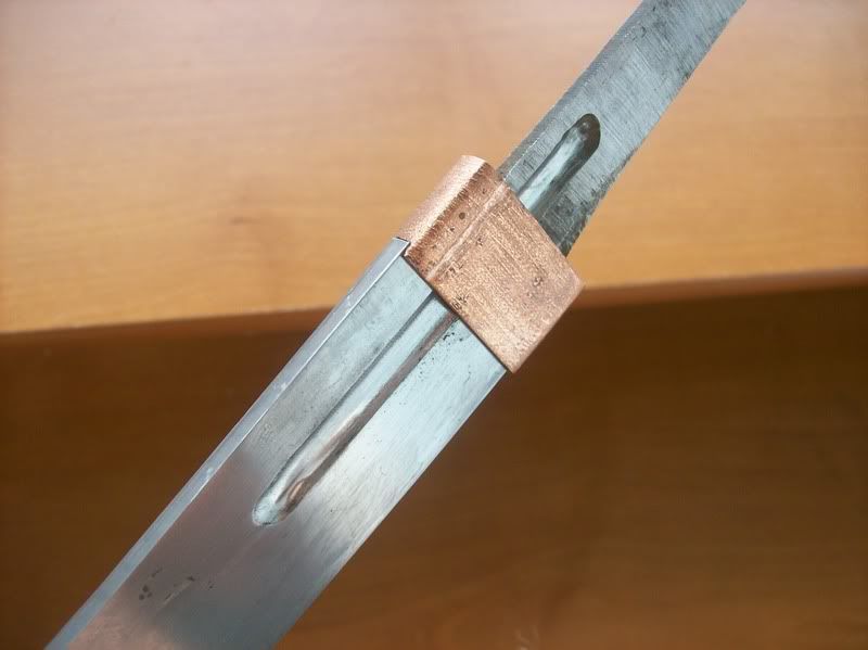

the fuller was forged in also, i usually use just a draw scribe i call it or a milling machine, but wanted to play a little with this. was cleaned up with deburring wheels then burnished to this stage
wow, where'd you get the tamahaganae?
i ordered it from japan, came as a large semi round smelting pour. hard as heck to forge from that to a bar........ makes me respect the power hammer thats for sure.....
not really crumbly, did break into two pieces when almost a bar, that stuff makes a 25 lb little giant stretch a bit and say damn...........
