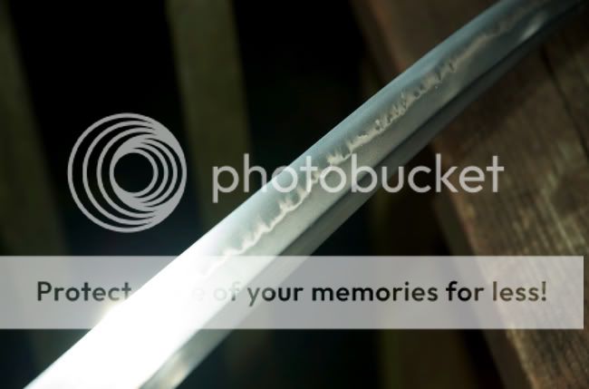

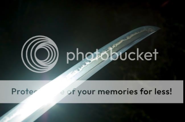

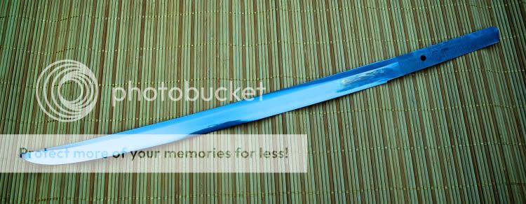

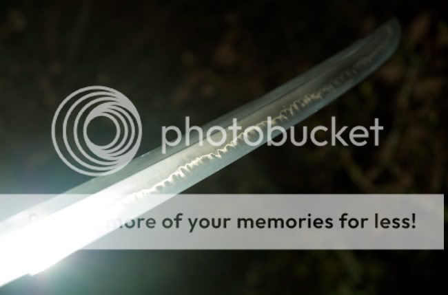

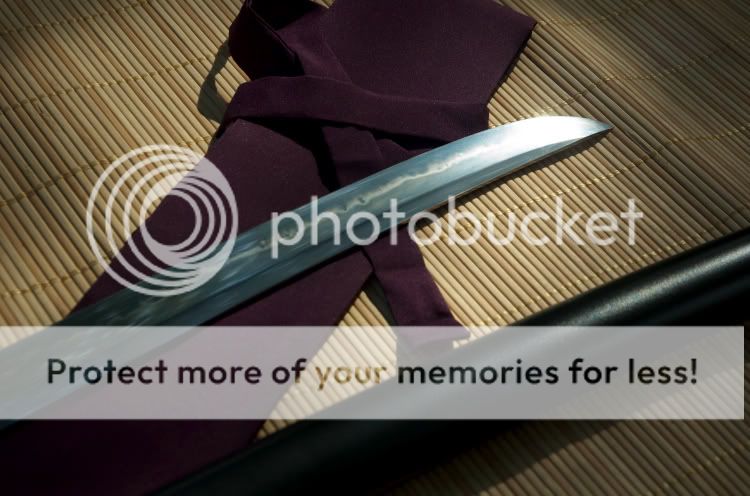

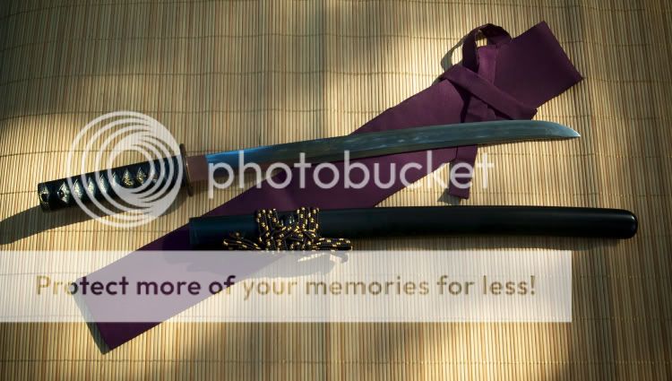

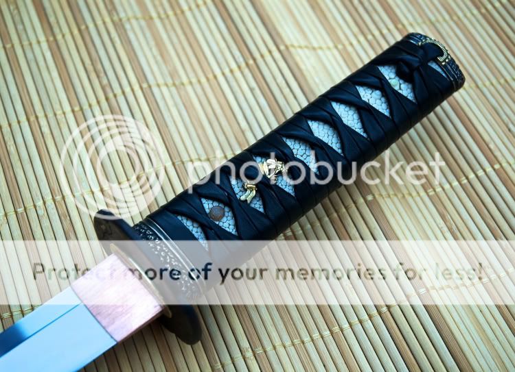

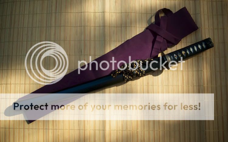

I finished this about a month ago.
The only real request was leather ito wrap and something black and yellow. In my searching for ideas for fittings, I came across some antique tsubas on ebay. This was one of my favourites and it found it's way into the project.
The blade is W2 and measures 18 3/4" from the machi to the tip. The sori, or curvature is a mild 6mm or 1/4". The geometry is shobu zukuri with a choji hamon.
Here's some photos. I find it very difficult to photograph swords so hopefully you can figure out the sum of these parts.
I wonder what you guys think of putting antique pieces on modern western approaches to the Japanese style. I wondered if it was in poor taste and had to think several times before going through with it.
