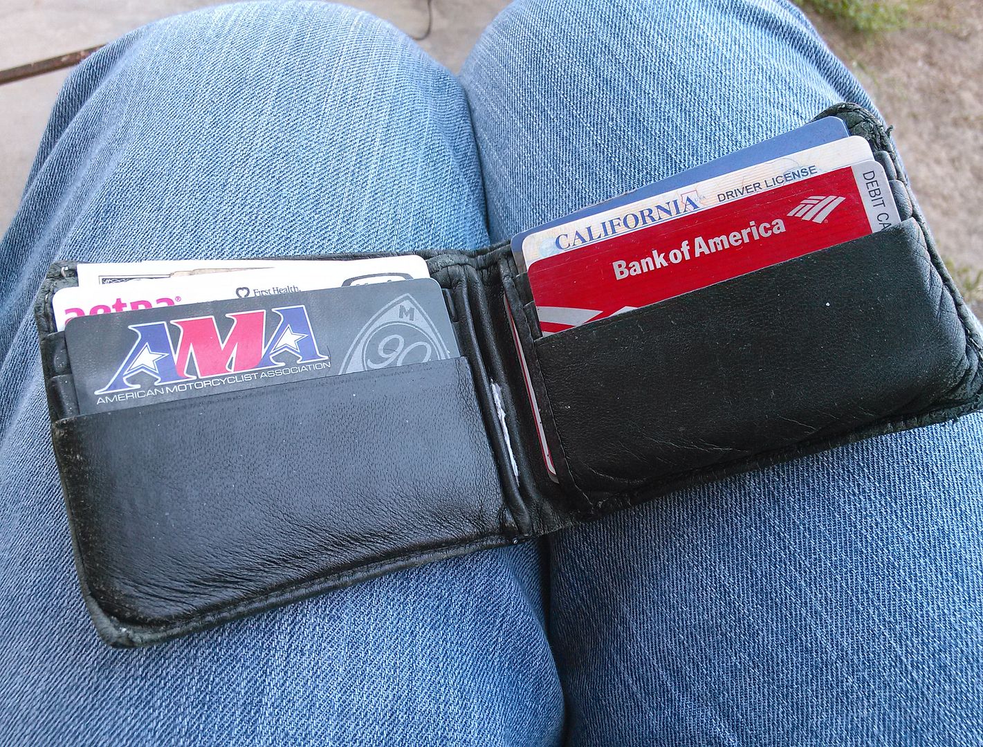

My cobra skin wallet has just about had it. It's been a trustworthy edc companion for about 5 years.
I have enough projects on my plate for the next 10 years, but let's pretend I found the time to make a wallet. :)
I will need to hand stitch this bad boy. I'm cool with most aspects of making the wallet, but the interior is tricky.
Those of you that make wallets, do you make your own interiors? If not, where do you get yours?
I'm just looking for something simple like my old one.
There are two bill pockets which I like because I can separate the $20's from the smaller bills.
One option is to buy another wallet, break it down and replace the exterior panel with shark.
Any and all advice is welcome.

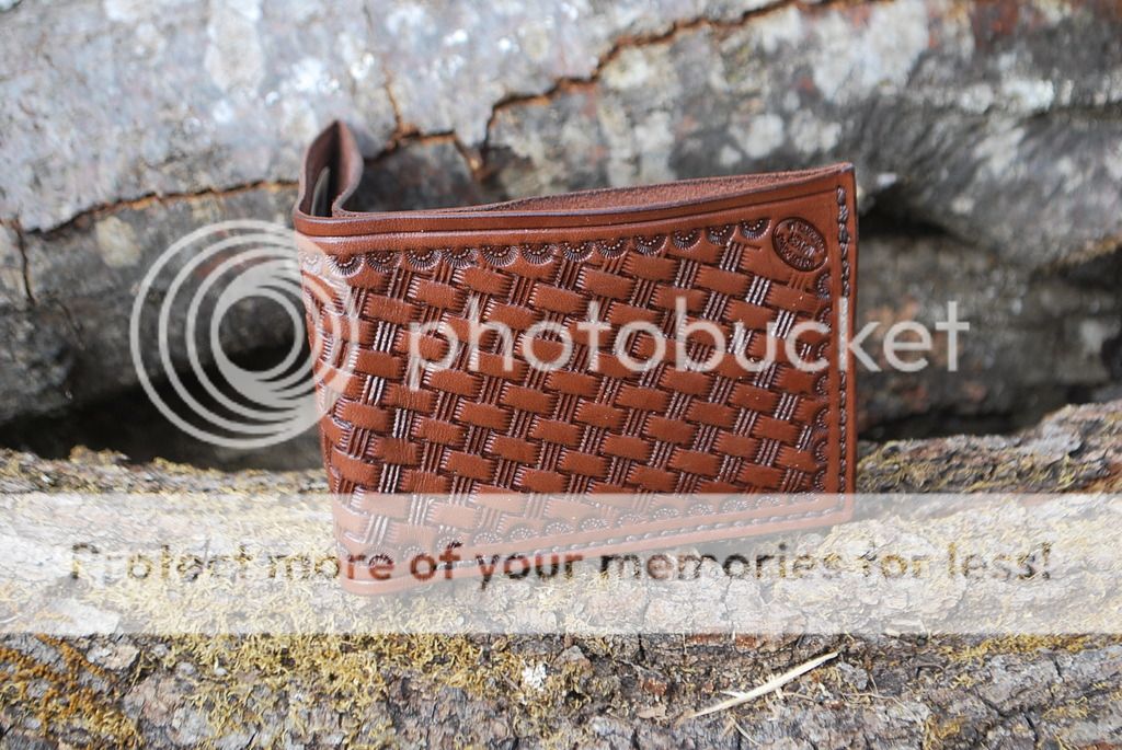

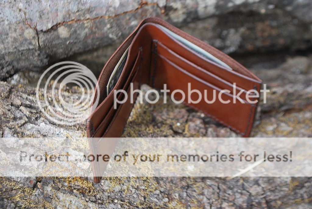

I make and sell a fairly popular 'slim' bifold, that is really easy to make. Just remember to leave your interior main panel about 3/8" shorter than the exterior to prevent bunching. You can sew the card pockets onto another piece if you want a third pocket on each side for miscellaneous, and add a cloth lining to the main pocket if you want a divider - the latter will give you that separation while keeping it thin. The cloth will wear out a long time before the leather will.

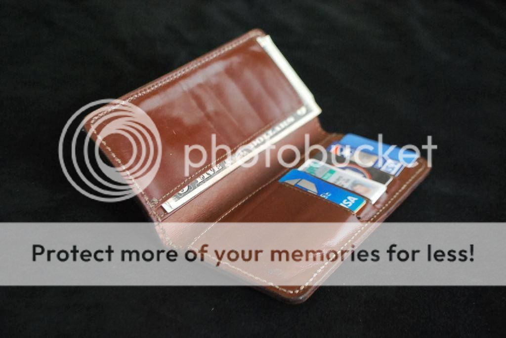

I have tried the Chaylor-Fenneli interiors with good results, but a lot of them use cardboard which I did not like. Springfield Leather now offers their own line of interiors that are of good quality and a little bit better on price. I use a lot of the Roper interiors which are really popular in my neck of the woods. Pardon the glue on this example, 'the cobblers shoes' scenario this was my test mule wallet.

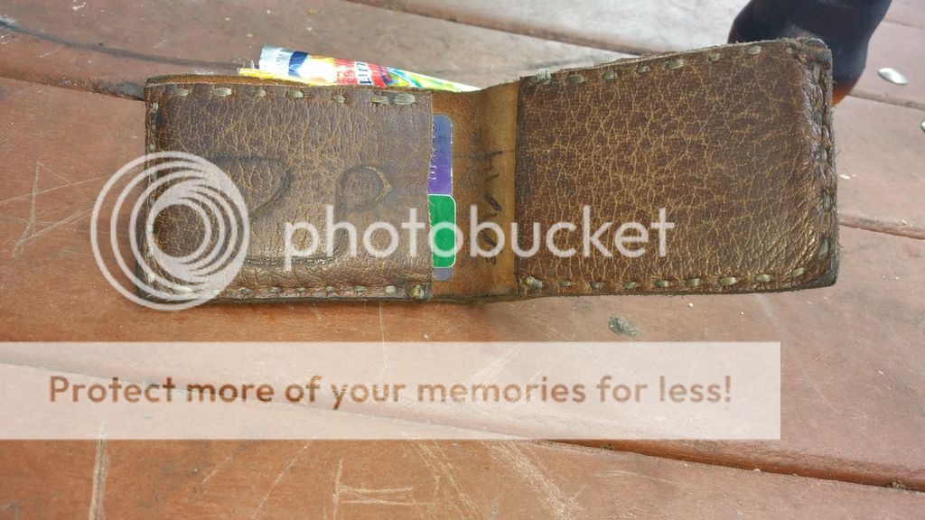

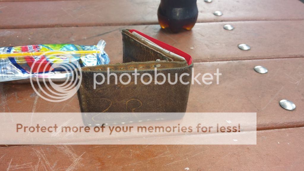

This was the first thing I ever made that required any kind of leather work or just plain hand stitching in general (yes I know very crude or for you guys just plain sucks lol) but I tried and have have it for 2 years now
Zack, that doesn't suck! If it works for you then its plenty good for anyone. :D
