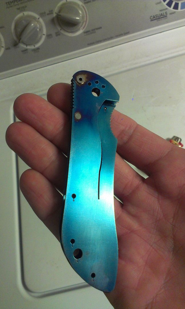

This was with four 9v's. I was really only concerned with the edges as these are liners. The process didn't seem to affect the detent, but I use the paintbrush method so I was able to concentrate on specific areas.
I'm going to try the submerging method next, but the PB method is really easy.

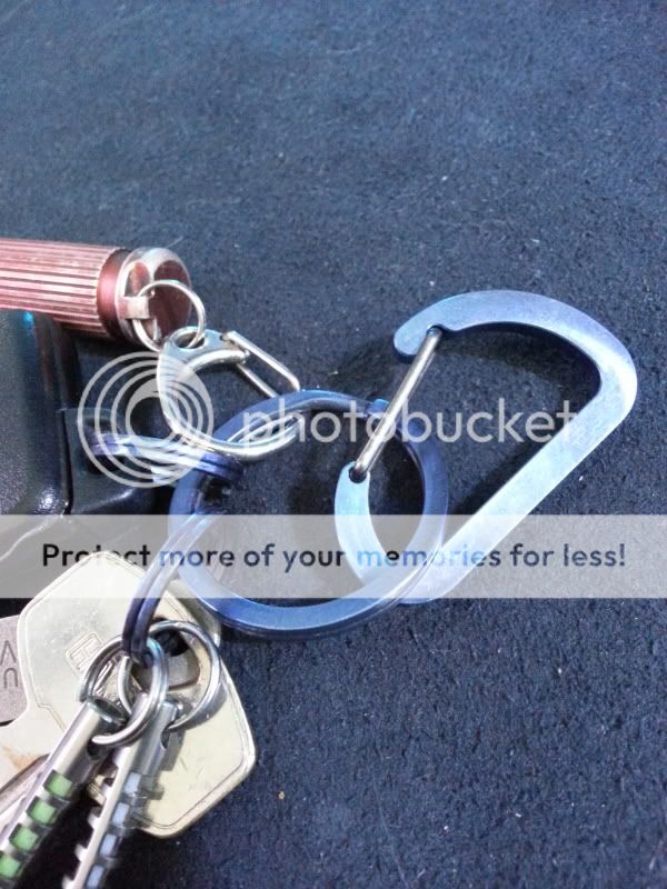

Just finished anodizing my Ti key rings, 30.5v exactly. My cameraphone sucks at taking pics, but they look better in person.
That's exactly right Moxy.

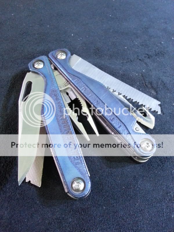

Anodized Leatherman Charge anyone?
I tried out the "paintbrush" method for the first time on this. It came out pretty good. One word of caution though. When I did this I used a Q-tip soaked in the electrolyte solution and attached the (-) terminal to it and "painted" on the color with the (+) terminal attached to one of the blades on the Leatherman. The (-) alligator clip was very close to touching the Leatherman while anodizing. It's therefor quite easy to accidentally touch the metal alligator clip to the Multitool. In my case I'm using my bench power supply which can limit the current in the case of a short circuit. Even so it did spark a little bit when that happened. So if I had done this with batteries, especially high wattage cells, it would have been ALOT worse because there is no safety mechanism that can shut off the power. Not to mention it would leave a mark on the titanium where the metal vaporized away. So DO NOT try the "paintbrush" method with batteries. It's just too easy to short them out accidentally. Also you need to wear insulating gloves when you do this. Before I thought 30 volts isn't enough for you to feel the shock, but actually it is. I tried it. It feels like a very light buzzing. It's not painful but it will still freak you out if you don't know it's coming.
I tried out the "paintbrush" method for the first time on this. It came out pretty good. One word of caution though. When I did this I used a Q-tip soaked in the electrolyte solution and attached the (-) terminal to it and "painted" on the color with the (+) terminal attached to one of the blades on the Leatherman. The (-) alligator clip was very close to touching the Leatherman while anodizing. It's therefor quite easy to accidentally touch the metal alligator clip to the Multitool. In my case I'm using my bench power supply which can limit the current in the case of a short circuit. Even so it did spark a little bit when that happened. So if I had done this with batteries, especially high wattage cells, it would have been ALOT worse because there is no safety mechanism that can shut off the power. Not to mention it would leave a mark on the titanium where the metal vaporized away. So DO NOT try the "paintbrush" method with batteries. It's just too easy to short them out accidentally. Also you need to wear insulating gloves when you do this. Before I though 30 volts isn't enough for you to feel the shock, but actually it is. I tried it. It feels like a very light buzzing. It's not painful but it will still freak you out if you don't know it's coming.

In the case with the Leatherman I could not take it apart, nor would I want to, so the Q-tip method is the only way to do it. Just be careful.
