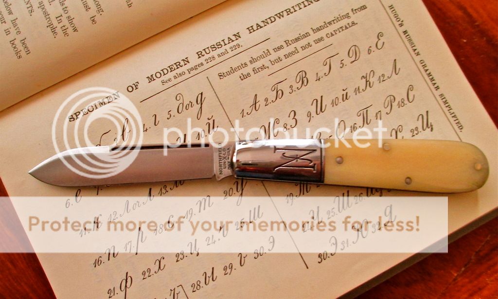

There definetly are barlows with spear points ;) What do you want as full length/bladelenght/handle length?
I would like a shorter one with the oal being between 3 1/4 to 3.5 closed and a blade length proportionate to that size. I like the shorter bolsters - the look of the older style chunky vs the longer more tapered.
I’m not sure that helps much, I’ll try to find a pic
Dan
