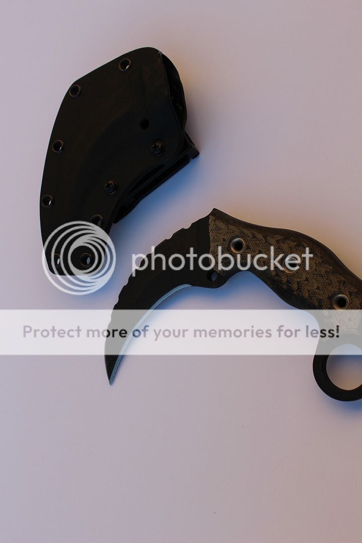

Ok friends, with the custom shop on hiatus, I have decided that I will break from my cycle of only BRUISER g10 and get into some exotic woods or specialty pieces of wood.
This is where this journey starts, a war boar

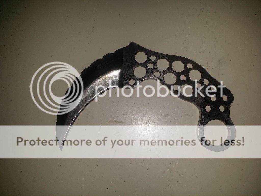

As we all know it can't stay black with black canvas.... So I call this stripper I know, Citristrip and we get down on it, so to speak. Do note all the holes drilled into the tang, if I had not put so much effort into getting the special piece of wood I would have just rounded the spine as I love the look.
Now the handle material I have selected is a 8"chunk of teak that is 3"thick because it used to be the deck of the USS NORTH CAROLINA battleship.
After selecting the species and select piece of said species I begin by making copies of the canvas grips from outlining their shape onto the wood. Then I cut it out with a coping saw then sanding the rest.
Then perfecting the new grip fit to the knife itself
Then I finish sand and smooth the task and prep it for tung oil.
Here it is with only one cost of tung oil with grips installed. I will probably end up with around 10 layers of tung oil but the color and richness will deepen with every coat.
I must say that being a wood worker by trade this modification was super easy compared to the g10, I just felt more at home with the material. Here are so more pics...
I made these grips slightly thicker as the stock war boar felt slightly thin in my hand. I will say that the two surprises I got in this mod were the cool lightening holes in the tang and the glorious INFI dimples in every flat piece of metal on the knife. I eventually worked it all of the dimples as I wanted a big finish or better. That's for your time hogs, any questions or comments will be taken below... Now in all seriousness let's drink....
wow...that's some historic handle material you got to employ...I think your repurposing is a great way to honor it...that's my 2 cents...
thanks for the view beneath the handles also, I'm pretty sure that's the 1st x-ray boar pics I've seen...love the dimples (I would have left 'em) & all the knockouts, very interesting...
