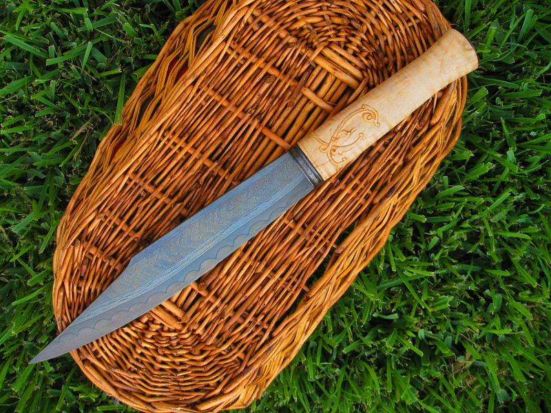

Beneath the beams of the super moon a few nights ago, my Muse stirred within me to forge a seax. The idea was to make a mid-sized knife, mabey 14" long in the blade, composed of many strands, forged in the old way, with the teeth of wolves, and eddies of swirling life-blood.

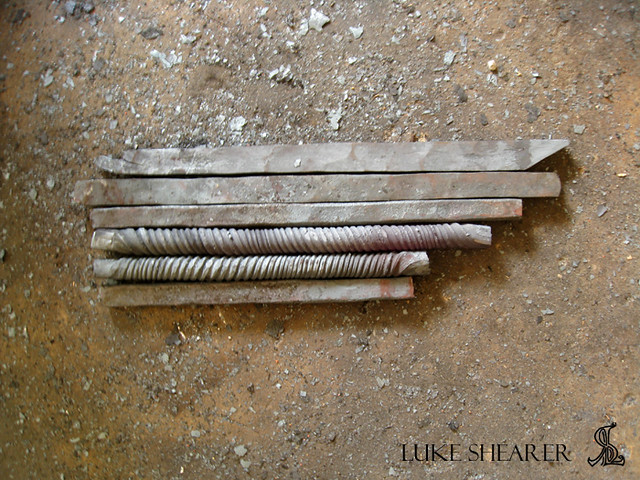

So My friend, Ryan Stevens and I forged out some bars, patterned them, and have begun to weld them together....
Twisting up a core
billets...

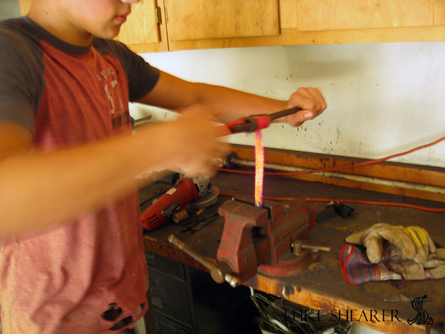

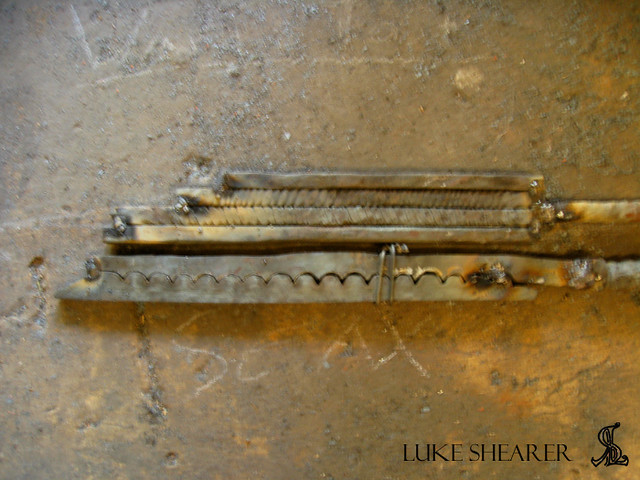

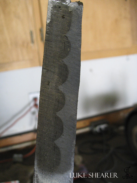

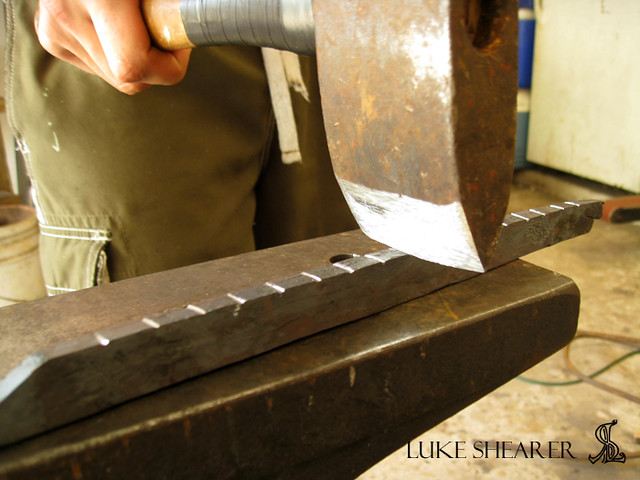

To forge in the teeth, I mark out every centimeter with an angle grinder, and then we use a special fullering tool to forge them in. (Turns out the tool was too sharp and we sliced through a few of the layers instead of compressing them...)
Grrrr!

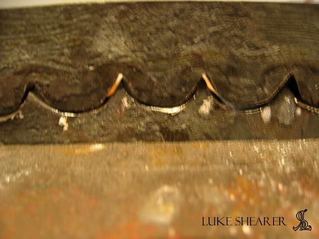

Meticulously fitting up the teeth. Its easy to make flaws if this is not done correctly.

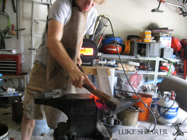

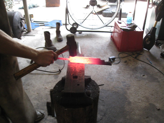

We decided to weld it up in two separate billets initially, one with the twists framed by wrought iron, and one for the wolf tooth, so we could keep an eye on it and give it special treatment if needed.

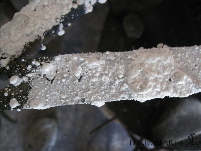

One trick I have learned to get flux into the joint earlier is to heat the
piece to around 700 degrees and spoon borax saturated water onto it. I
don't know if it really helps, but I like to think it does.
Wire brushing...
Welding...

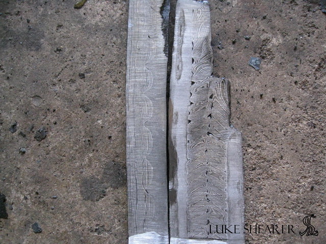

Warg teeth emerge....

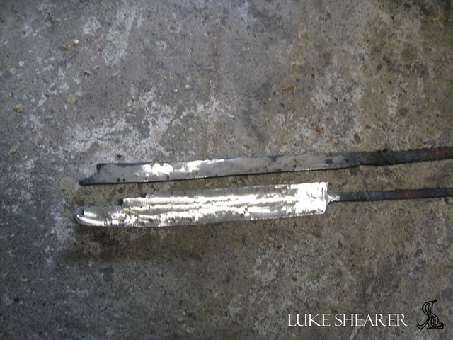

Scrubbed mostly clean...
Next step is to stick these two together and forge into a blade.

That is looking good. looking forward to seeing it done. But Man! Forging in shorts and sandals???

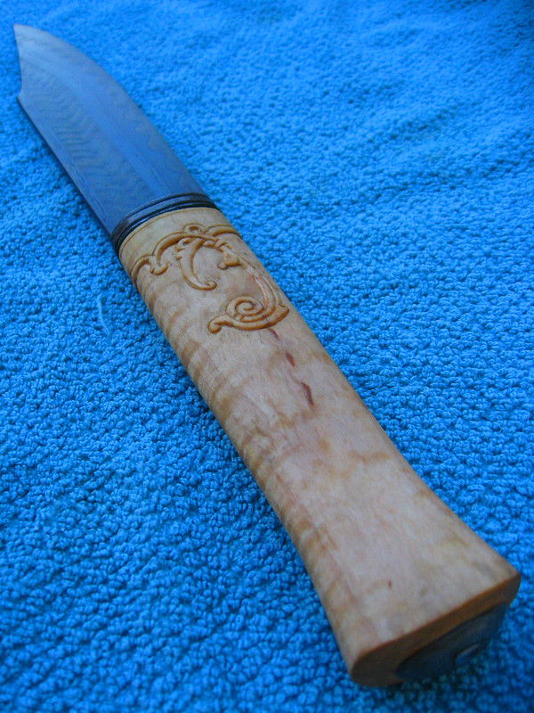

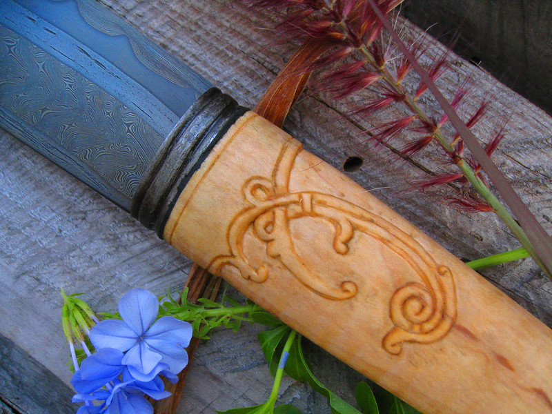

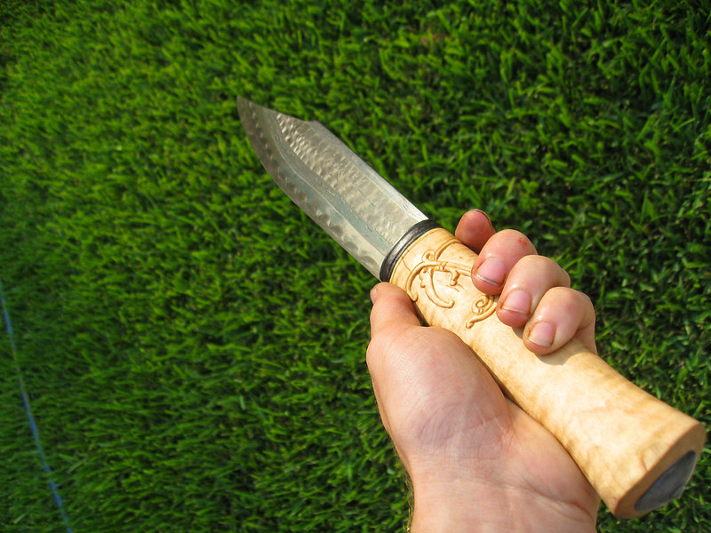

Wow! That's a beauty and a beast at the same time! Awesome blade, great carving on the beautiful handle. Excellent work!
