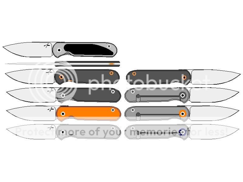

Gareth is working on his next version of the Warlock and has just sent me some pıctures and info.
The new version will be a bit bigger with a blade length of 3.4'' as against the current one which is 3''.
He is planning to modify the lock cut-out so that it will be easier to disengage the lock.
He will be putting on lock protectors (which can be seen as the coloured rings on the titanium scales - right hand pictures).
The top picture is of the upmarket version which will have inlays of high end natural exotics like mammoth tooth ivory and mother of pearl with damasteel (stainless) blades.
The second one down is an ultralight version in which both sides will be carbon fibre (with no metal liners) and gold plated pins. The lock will be inlaid to minimise weight. The inlay will be a simple titanium leaf to act as the lock. The trick is how you inlay it. Basically a small dog-leg is milled into the CF and is undercut at the rear of the inlay. This creates a shoulder that matches the titanium part and holds it down while the dog-leg keeps it stable and transfers the stress of locking the blade. No screws necessary. To me that seems to be a serious amount of engineering which will require great precision.
The bottom 3 are variants of his standard MkII with different scale material. (C/F, Orange G10 & Ti)
His 3 steels of choice will be RWL34, M390 and Damasteel (stainless) - blades to be 3mm, same as the current one.
Gareth is also looking at getting some pouches made in Stıngray skin. These will fit all MkII variants but will be partıcularly important for the ultralight as there is no metal on this to take a clip.
Not sure when he will start making these as he has got a backlog of MkI's and other work to clear first.

Here you go :) Latest rendering of a few of the proposed styles:
Top is Damasteel and mammoth molar (I actually have that piece of mammoth)
Next is the ultralight version. Damasteel blade, both scales will be CF with an inlaid liner lock. Gold plated pins and gold anodized lock.
Pearl inlay
Orange g10 - textured
CF scale
Obviously there will be a full framelock too, just tossing around ideas to give it a texture or keep it super simple.
Blades will be in RWL-34, M390 or Damasteel, first and foremost they need to perform.
