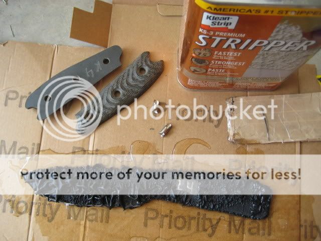

Hello all. I am trying to find a SH Satin Jack. It is not easy. My question is, if I were to buy one with a coated blade, and then sand or strip off the coating, would I be able to send it back to have the handle put back on? I really want a satin finish on the blade. I know the warranty is out of this world, but I don't know about something like this. Would this seem like it could be possible? or would i just end up with a satin blade and no handles? thanks for your help.

Well, i really like the look of the rivets. Also, i called the site phone, and the woman there was very nice but said she did not know if it would be covered or not.
Occassionally the custom shop will satinize a coated blade but generally they'll only recoat in the color of your choice for a nominal fee. You can do the handle reattach yourself with 1/4" tubing, a vice, 2 phillips bits and 2 dry wall screw heads--as told in one of the tutorials.

this one was stripped with the handles on, I have not seen a problem with doing it that way...
If you strip the coating and sand your knife just be careful not to overhead the edge and mess up the temper. If you mess up the temper that it is not covered.
Wow, those pics are just what I want. Is there a special kind of stripper you used for that? and how, just submerge the whole knife into a tub of that stripper with the handles on it? thanks, i appreciate the help.
i just bought paint stripper in a can from the hardware store, brushed it on, waited, washed it off, did a little sanding(not much), them convexed the edge on the belt sander. If it is cool enough to hold, you have no worries about ruining the temper.
oh, and putting the knife in the liquid, will that ruin the strength of whatever epoxy/adhesive is under the handle slabs? thanks
You do NOT need to take the handle off to strip it... I did it.... but then again I'm nuts.
Here is the stripper I use. It's less expensive than the other type. ;)
