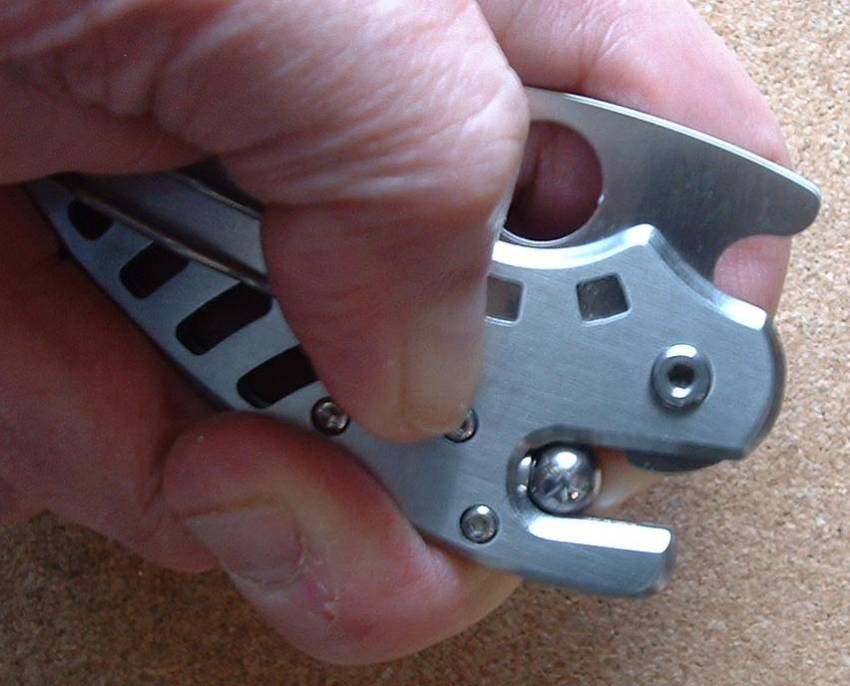

Well, I am neither an engineer nor a machinist, but in looking at the one and only Poliwog I own I would suspect that the cutouts you seem to feel are incorrectly placed (but which the inventor of the lock and designer of the knife have assured you is correct) exist because the diameter of the spring and plunger is greater that the distance between the two scales, so you have a relief cut on the inside of the handle intesecting the chamfer on the outside.

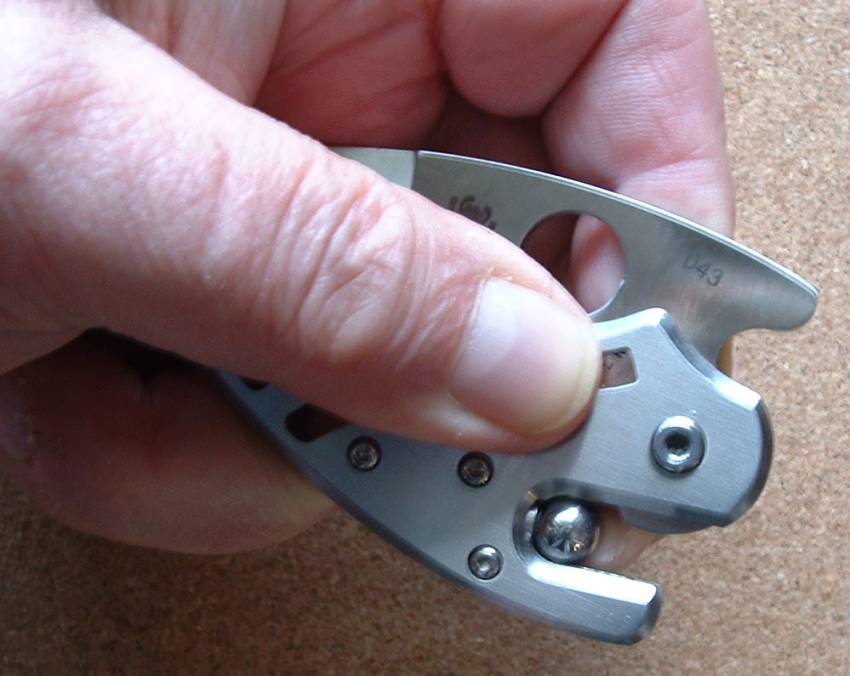

I'm not Sal either, but here's what happened when I took the liberty of trying to do what you requested he do with a Poliwog...
Spring and plunger seem to retract fully into the handle, ball seems to be about as far back as it can possibly get, and, at the very least, is considerably further back than it would ever need to go in order to open or close the blade.
Have no clue on what the actual washer count is, as I have not taken mine apart and have no intention of doing so. Can say, from observation under strong light, that the gap between the blade and the handles seems equal on both sides so would guess that the number of washers on each side is the same.
