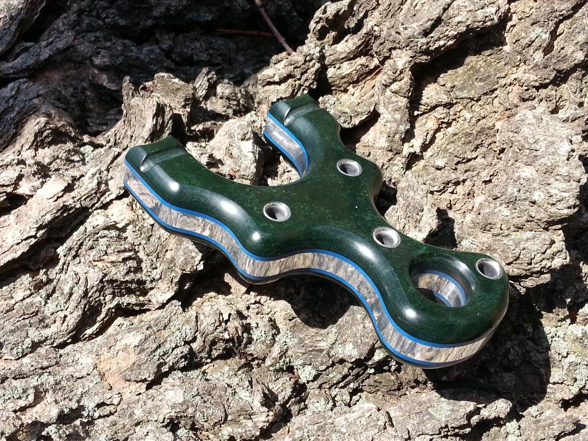

I found these photos of the stuff in green. Seems to take a very nice shine when polished. I like the fibrous and organic patterns.

the thought of a really cool custom slingshot had never crossed my mind. With 2 young boys and several young nephews I'm going to have to try to make a few of those.

That's a nifty slingshot. Any idea who made it?

The slingshot is by Chris @ Yo Slingshots. Super nice guy and very helpful when I e-mailed about Warwood.

I received another mail from Chris the slingshot maker. Pretty interesting info about WW's toughness:
"Hey again,
Yesterday while shooting one of my Warwood slingshots (wine color), I hit the fork tip real hard with a 3/8 BB. In times past this would dent wood and micartia pretty good. Instead it was a lot more like hitting g10 making a "glass" ping sound. I had to look real hard to find where I hit the fork. Just to say I was impressed. I thought it would be much worse.
The fork tips are one area I worry about due to the fact that they can de-laminate and hit the shooter in the face when the rubber bands pull back.
I am sure you as a knife builder are worried about dropping the knife or throwing it.
I plan to do some ballistic test on a glued and pinned fork soon, I just need to mess one up first so I wouldn't mind :)"
Hey friends, I was looking for some info on alternative knife handles (stall mat) and I found this thread. I am the builder of that Slingshot and I got a smile when I saw those pictures. Just a few more tips on Warwood. Use fresh and sharp belts to sand and shape. I use low speed on my router to shape and of course a new carbide blade. This material will "burn" if it gets hot while shapping. When pinning I also found that it cracks easier than many other similar materials, which is weird for such a tough product.
