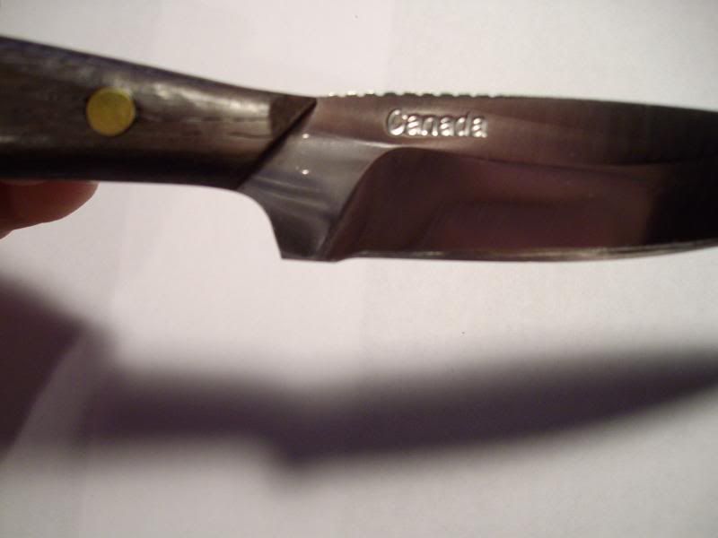

When a knife doesn't have a little notch in the blade, you end up with either a little Kick, like the Delica above, or a little space right where the blade meets the handle that can't be sharpened on waterstones, like on these knives.
It's hard to tell from this picture, but that effect gets worse over time as you wear away more and more of the blade:

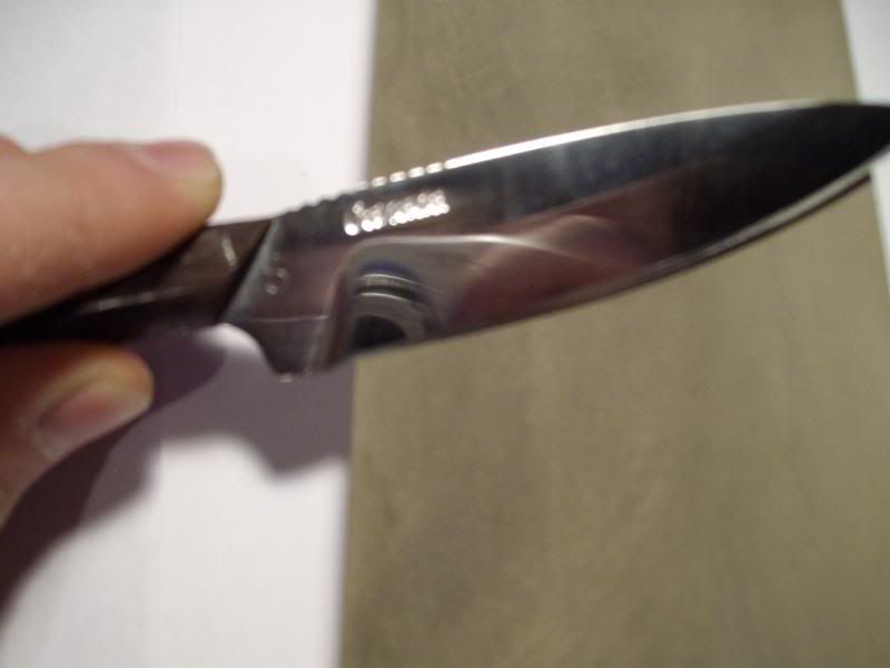

While sharpening, this is about as close as you can get to the tang of this particular knife without having the tang grinding at the edges of your stones:

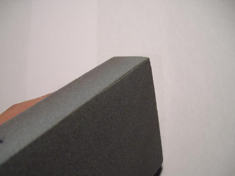

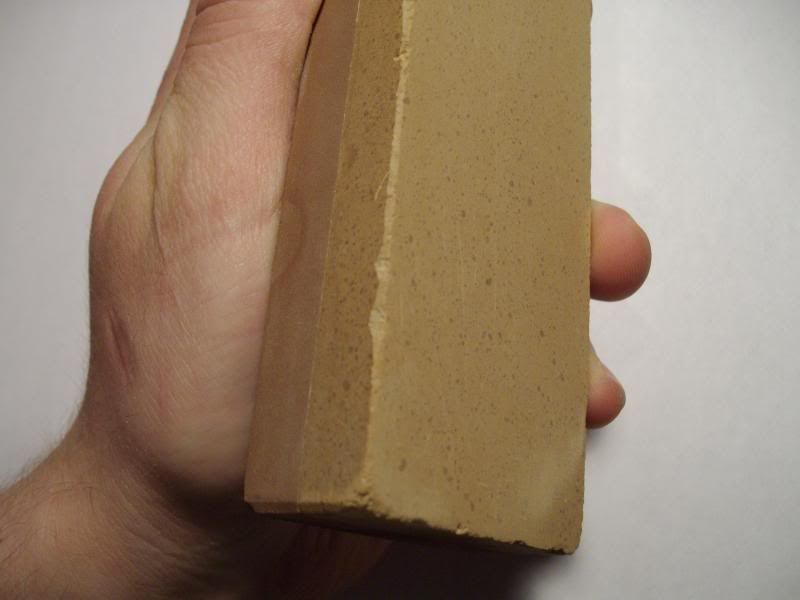

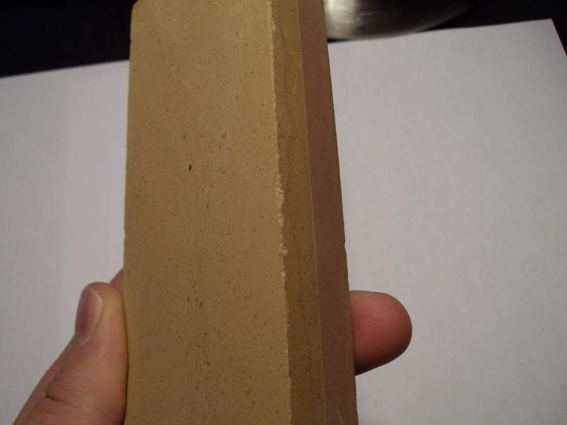

The principle works the same for knives that have a kick. If you slip and let the that area, or the Kick, scrape against your stone, this is what happens:
You end up mangling your waterstones. These aren't high end stones, but you can see how this becomes a pain in the ass and would really ruin your day if you were using expensive stones.

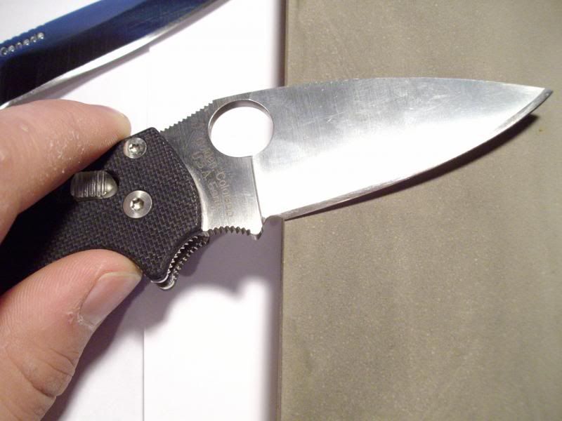

With a little sharpening choil, on the other hand, it's much easier to avoid rounding / chipping the edges of your stones. You don't have to be nearly as careful about babying your stones this way, and sharpening becomes less of a hassle.
