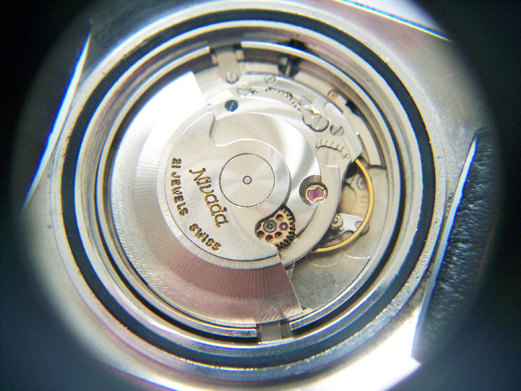

This particular model doesn't have an O'ring not really a dive watch
They skipped it in assembly, which could be why they used extra grease. Maybe they were out of the right size. When I bought my wife's Casio AMW340, it had a ¼" loop of rubber gasket sticking out from under the case back. Apparently they ran out of gaskets for AMW340 (watch on right), so they used a gasket for AMW320 (watch on left) and cranked the case back down real hard.

This is a rubber O ring gasket
and this is where it usually goes.
When you open the case it should be obvious. Of course if they assembled it with a gasket, you wouldn't need to guess.

I am not so fastidious. My watches are cheap beaters and they use the thinnest gaskets. The gaskets stretch and you can use one that is too small. Just don't use one that is too large!
Any metal watch should have a gasket, even a Seiko 5 with "30 meters" (3 atmospheres) water resistance. Some really old vintage watches were dust proof but not water proof. If you left one in the bathroom while you showered, the crystal would fog!
I stand corrected sir! I unscrewed the back and took a look again, this time I noticed that the cover has a seal along the outside of the threads, so that was a relief to see that there!
