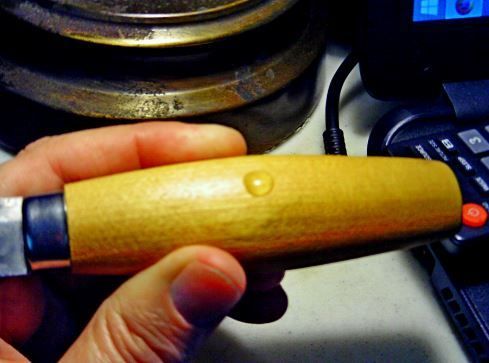

Have you tried Snow Seal and a hair dryer? I use it on shoes, sheaths and my untreated wood Mora handles....
Still beads up water 2 years after I treated it...
