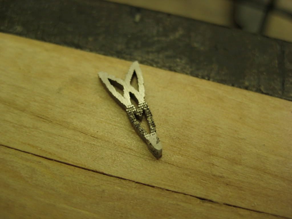

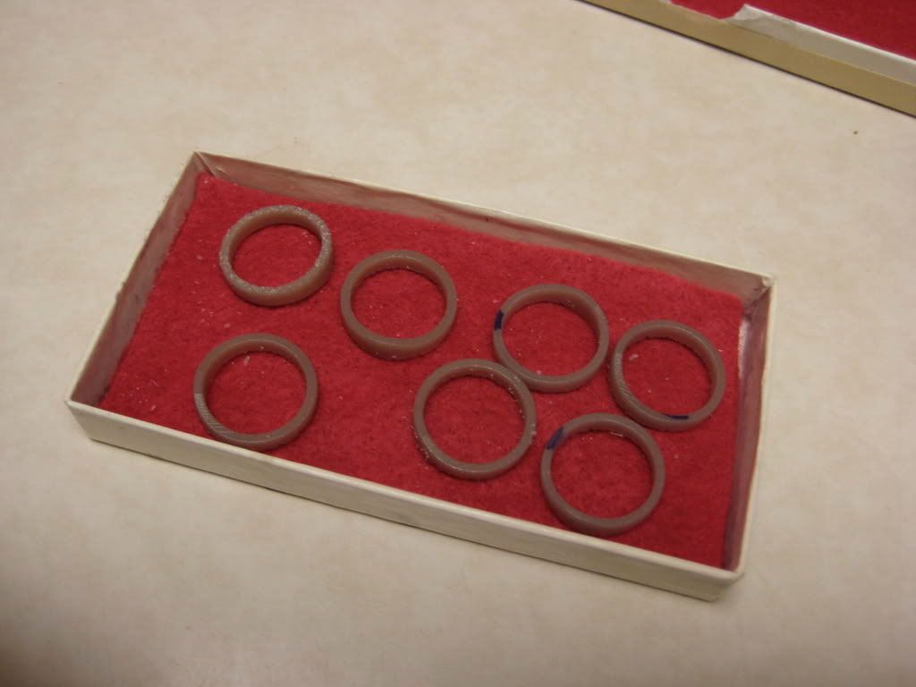

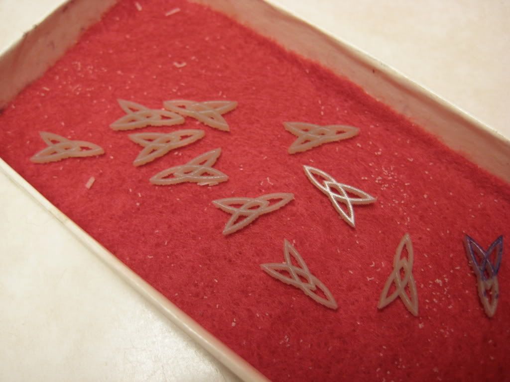

i am trying to make a engagement ring for my girlfriend. the ring is gonna look sorta like this:
i was trying to carve the trinity out of wax.. by hand.. and that WASNT working.. i know some of yall can do it.. but i cant.
so i drew it up on the computer in Inventor and we plotted it on the wax machine. here is what came out (after a little clean up)
isnt that sooo cool?!
i am gonna try and plot the band too so they fit together.
anyway..
just wanted to show you..
i'll keep you posted.
thanks
~Chris

Ah very cool Chris, your lucky to have that equipment. I definitely wouldn't want to hand carve that:eek: Just a heads up, be real careful packing that wax, plotted waxes are extremely brittle.

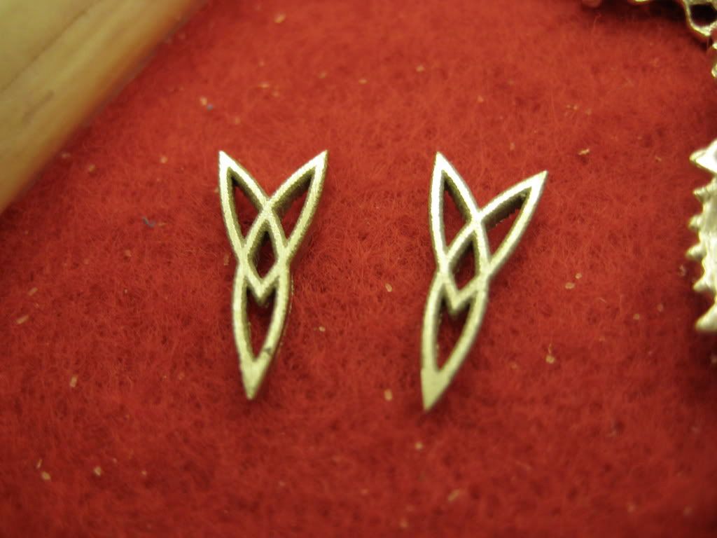

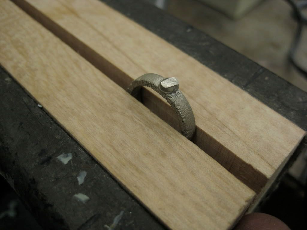

here is the work so far...

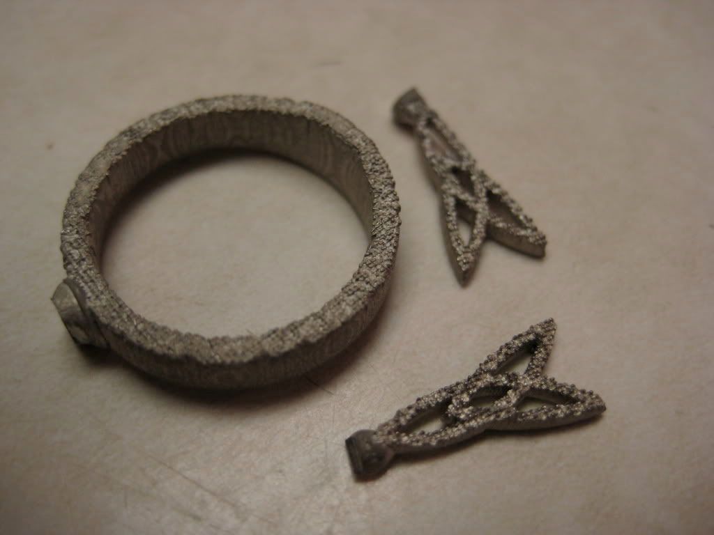

got the castings back, starting to clean them up. hoping to assemble then next thursday.
let me know what you think.
thanks for looking!
~Chris

Hi Chris,
Looking good!
Are you planning on doing any more file work? Looks like you could do more on the out- and in-sides of the findings using some needle files and or jeweler's or dental rotary bits. The band too looks like it could be finished more. Most jewelers finish to 600 grit then go to the buffs.
Hope you take some good pix with Stacy. That'll be way cool!!!
All the best, Phil
Investment casting? It's working out pretty good! I admire the fact that you chose to make one instead of buy one :thumbup: .
hey guys!
phil, i am not done by any means.. the band will be up to 600 at least. as will the trinities. the reason for casting them as seperate parts was to facilitate clean-up. i have just gotten started. i will do my best to take pictures with Stacy.
