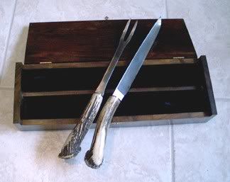

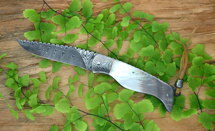

When, I was about to start collecting custom knives Wayne was the first maker that I contacted since we both lived in New Hampshire. He was very helpful in giving me information about custom knives. There is a great article about him in "Best of Knife World Vol. III" which is still available from Knife World Books. Before I could get a knife directly from Wayne he moved to Hawaii. I have collected quite a few of his knives. I believe that he is mostly known for his folders. He made them of carbon steel, damascus and his high density damascus. He used filework on most of his knives. Here are a few. Jim Treacy

Damascus and abalone lockback folder

Carbon carving set

Mr Treacy,thank you very much for your post.That is a fine collection you have.The "high density damascus with mammoth ivory" is a beautiful folder. 61/8 inch blade, folder with ivory?!!!.That is one BIG folder.Like it very much.You had mentioned that he made carbon steel,damascus and "high density",damascus blades.What is high density damascus,I am not familiar with that term.Do you know what steels he used to make most of his damascus.Also on his carbon steel knives,did he favour one steel or did he use a variety of steels.
Raj, Wayne Valachovic was one of the earlier ABS Mastersmiths. He got his MS rating in 1982. His high density damascus had over 5,000 layers of nickel, O1 and low carbon steel. He made some with 22,000 layers. He claimed that they were tougher and had better cutting abilities than regular damascus. In those days alot of damascus was made with high carbon and low carbon steel. Today many makers use different composition high carbon steels for damascus. He was a maker who tested his blades for performance. His carbon steel knives were made mostly from O1 I believe.

Mr Treacy,thanks for all these pictures.That carbon steel folder of yours with the curved bolsters,what is the wood on it?.Is it burl walnut.
The" Bischaeg", is very nice.What is the county of origin for the Bischaeg?.

Raj, The wood on the folder is African Blackwood. The Bichag ( I originally misspelled it in the description), is from Persia (now Iran). The blade is 7" and the knife is 11 1/2" overall.
