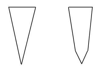

So I hung a True Temper Western pattern double bit on a nice handle about 2 months ago. Really put the time into this handle too- shaping, working on perfect fit. This axe was/is my main falling axe for big jobs. In use, performance is great, but I noticed the last time I took it out (12" pine tree), the wedge worked its way up about 1-1.5 mm. I reseated the wedge, and set back to work doing some bucking, and by the end of the day, had the same problem again. This hang went really well, good wedge proportions, but as usual I don't use any metal step wedges.
My question is, what causes wedge rise, and why on this particular hang? I think I'll keep it as it is now, but in the future I might pull the wedge and see what's going on.
John
Usually if I get a really tight fit this won't happen, except on things with really short eyes (hatchets, Hudson Bay patterns) which can be more finicky. Since I started making my own wedges, I've nearly eliminated the wedge rise issue on my full size axes. I just make sure to shape the wedge like the shape on the right, not the left.
I also rough them up. If they are super smooth they will be more likely to slip. You could always add a dab of glue, I don't, but you could.
So basically you're saying it's the sharp taper of the wedge that is pushing it out? Makes sense. I like the rough-up idea too. Thanks M3mphis.
