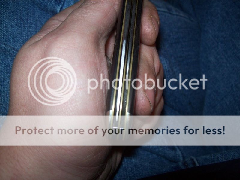

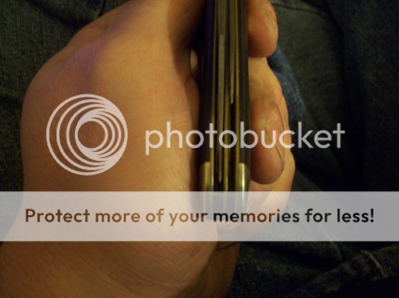

i think i got a couple pics
been trying to get something to show
anyways, this is what i am talking about
one with flash, one without
wasnt sure which one would come out better
oh and for the record
i know its not going to affect my knife, it wont cut bad or it wont affect it in any way
but i truly believe its because the blade is bent slightly

Rsmith, I'm almost certain that's a product of the grind, you can see that the mark side is quite straight. You could also get a little curve like that from an uneven swedge, although it likely wouldn't be that pronounced so close to the point. Still haven't had a chance to get photos of the grinding process, I'll try Monday.
Eric
