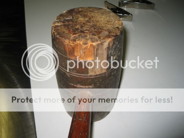

I have been talking about alternatives to expensive Poly Mallets. I took some time to build a few "Joiners Mallets" from these basic plans:
http://www.woodworkingonline.com/wp-content/uploads/2006/11/Joiners Mallet.pdf
I made a dead blow (24 ounces with lead shot in the center) and one without (14 ounces). The wood is Oak and Walnut Laminate - with Walnut wedges in the head to join the two. I used a rasp, file, and sandpaper to shape the handle
So - this got me thinking of another thread I read on here where someone mentioned using the core of a bowling pin. I read somewhere else that bowling pins are made, generally, from hardwood maple. So - I gave it a shot - I mean - who doesn't have a few bowling pins laying about?
I cut them open - squared them up - beveled them - put a 1 1/4 hole through it - put a hardwood oak dowel through the hole - made a walnut wedge to hang it with - and got to work with the rasp and file - and cleaned it up with sand paper.
My kids loved these - so I 'antiqued' them a bit so that they could double as "Minecraft" Crafting hammers (Halloween?) and there you have it.
These are 13 and 15 ounces respectively.
Sorry the pics aren't the best - but I wanted to share. Total cost in these is about 3 dollars for all of them - and I figure I can wear out a few hardwood heads for the price of a poly mallet.
We will see. Either way - I have some cool shop mallets.
