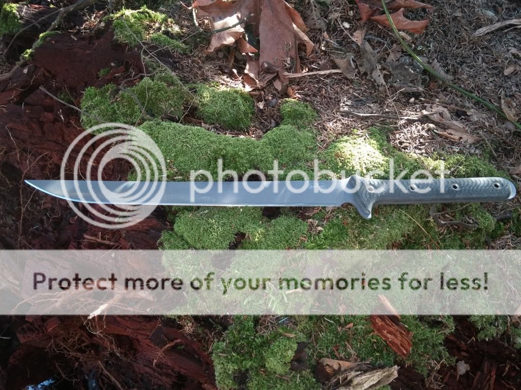

Well, my Rucki is here, but.... I'm underwhelmed. EDIT: Reground the bevel
May 10, 2012
1,812
It's gorgeous, it feels incredible holding it, but holy cow that edge...
Why would you leave a slashing/stabbing short sword so thick behind the edge? I'm comparing it to my KDSH, a dedicated "chop through all kinds of stuff that probably shouldn't be chopped" tool, and the KDSH is thinner :eek: (a difference of almost half a milimeter... The Rucki is roughly 1.5MM thick where the edge bevel starts. That's like an axe.)
I was so excited to get this thing, but at this point I have a feeling I'll probably just sell it off if I can't find a knife pimp to thin it down a bunch...
I'm sad now. I so want to love it, but when it can't even slice through a blackberry vine... (it kinda mangled and broke most of them, without really cutting them...)
Okay, so... That was the most nervous I've ever been using a belt sander. But, I successfully raised the edge bevel higher & thinned it out just a bit! Woo! It had one of the shorter final bevels I've ever seen - that combined with the thick edge made it... Unhappy. That also made it fairly easy to fix, though. 5 minutes with a 220 grit belt followed by some quick polishing on the 400 and very worn out 600 (which now acts like a 1000) grit belts resulted in a decent polished convex edge. I walked up to a tree, hoping that I hadn't just wasted my time, and flicked the tip through a branch. It sliced it cleanly in half! I did it! :D
This is the first time I've taken a blade worth more than $5 near a belt sander... :eek:
(I've practiced plenty on cheap kitchen knives, but still.)

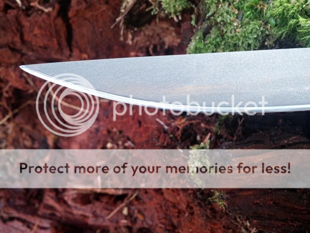

Nope, the apex of the edge is razor sharp. I can shave hair with it quite easily. It's just such a steep edge angle, due to the thick grind, that it can't take advantage of said sharp edge apex.
Mmmm... Understood.... Sounds like a major job is needed here.....major edge profiling? ..... Getting the entire blade thinned out is an option best looked at by the Swamp Rat shop, I think. My 2 cents.... Pull back on that edge angle and see how you like it. Still a tough, durable blade. Just saying.
I feel for you.:thumbup:... Please let us know....
Post-regrind... The bevel looks normal. That should give you an idea of how short & thick it was before. :p
...looks sweet from here.... You done this before?...
Never on a high value blade... I've reground thrift store kitchen knives, pizza Ulu style cutters, cheap machetes, and a couple of cheaper folders. Trying it on something valuable was scary. lol
What did you use?.... Ok, I read what you added at the beginning of your thread ;)..... Niccccely done:D:thumbup:
