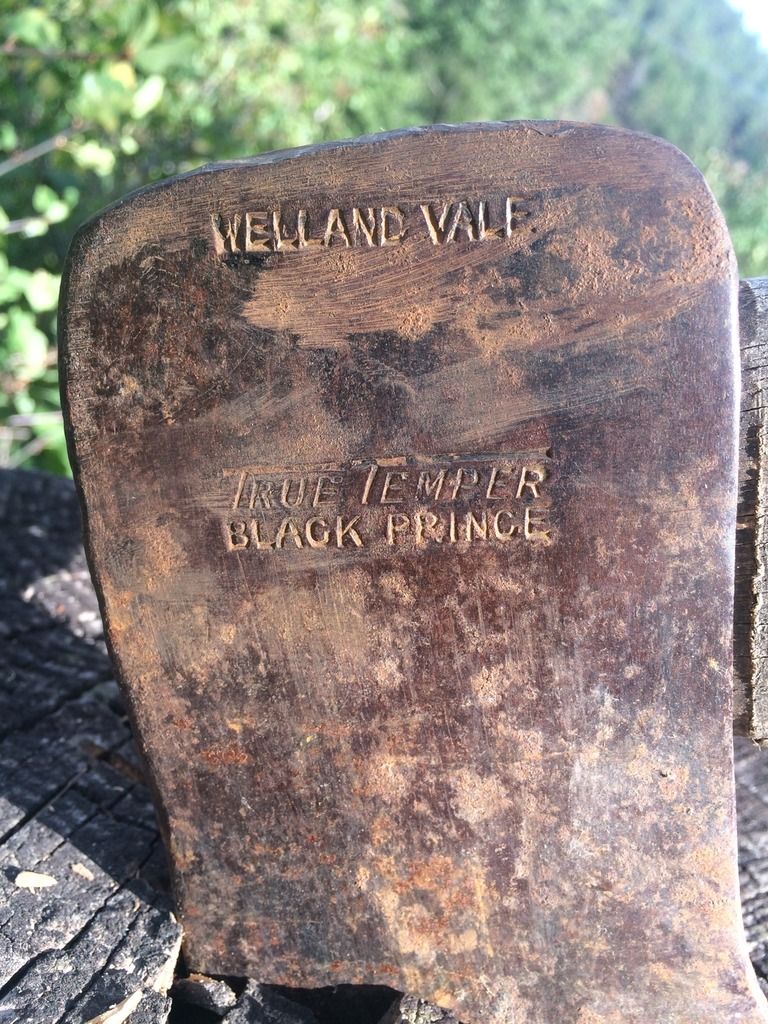

I picked up a axe at a garage sale that's logo says Welland vale true temper black prince. I'm not to familiar with this brand, does any one know any more info on these. it seems to be in really good condition the poll isn't even mushroomed or anything like that.
It's a true temper black price head, sold by welland vale.
It looks to be in good condition, and will clean up nicely.
After you take a brass wire cup in a drill or angle grinder it should look really nice 👍
( please no vinegar )

What other brands would this be comparable to? In terms of quality and steel. And where was it made?
Quality similar to True Temper Flint Edge which is to say better than anything but a Kelly Perfect in the Kelly/True Temper line and equivalent to a vintage Plumb or Collins Legitimus. It's a top shelf axe. It's in great condition.
Welland Vale was an old and esteemed maker of axes in St. Catharine's, Ontario, Canada. The company was sold to American Fork & Hoe in 1930 and became part of the future True Temper team. The plant was finally closed in 1965. Forum member 300Six can probably give you more details about the company.

Square_Peg, your comment above about this axe being equal to most in the Kelly line except the Kelly Perfect - I agree, but with a question. My assumption was that the 'Perfect' axes were made with the same steel, always with the bevels, but the name was just utilizing a widely known brand. Did the 'Perfect' axes use higher quality steel?
I haven't seen published what types of steel Kelly used. I suspect the Flint Edges and Perfect may have been made from the same steel. But the Perfects were advertised as having a hardened poll, an important upgrade IMO.
Having seen so many Flint Edge axes and pulaskis with a Forest Servce stamp I would presume that the Flint Edge met or exceeded Forest Service specs.
"3.2.1.1 Steel composition. The tool head of each type of ax shall be forged from fully killed plain carbon AISI/
SAE steel containing 0.72 to 0.93 percent carbon, 0.30 to 0.90 percent manganese, not more than 0.040
percent phosphorus, and not more than 0.050 percent sulfur. Steel composition of the head shall be deter-
mined as specified in 4.5.1.1."
Full specs:
http://cedarriverforge.com/Photo-index/axephotos/Forest Service Axe Specs - 5100_9D.pdf
