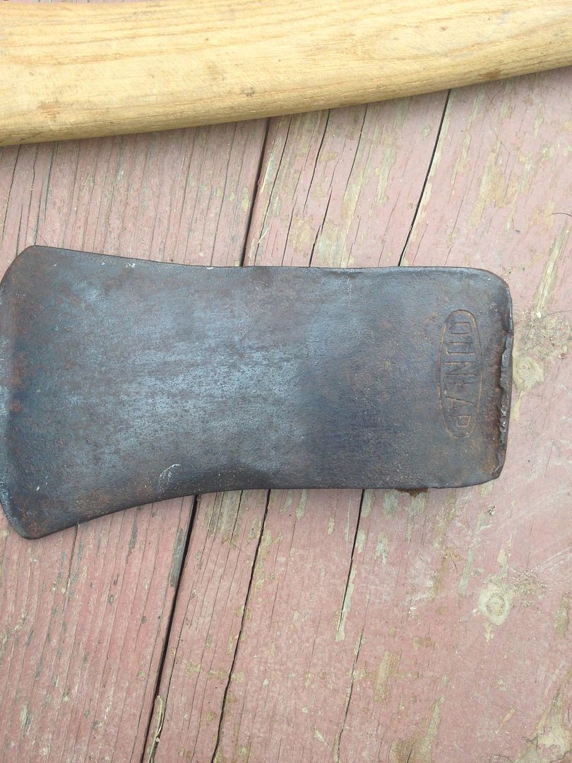

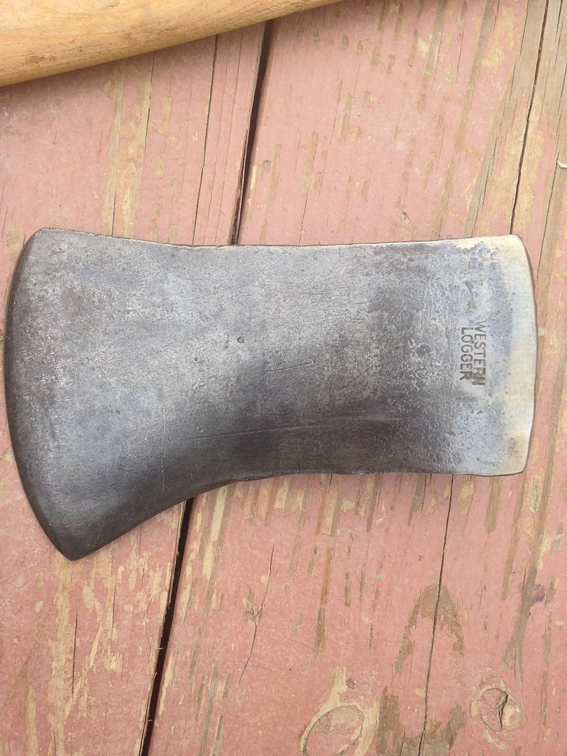

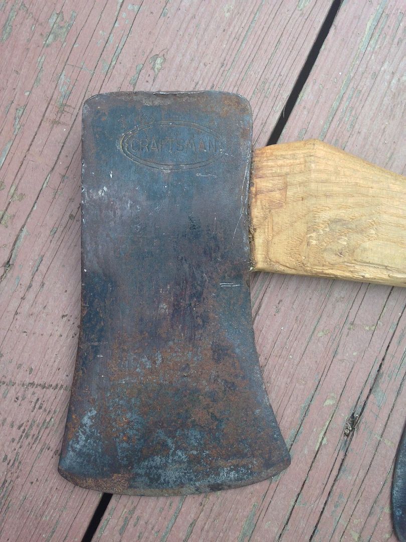

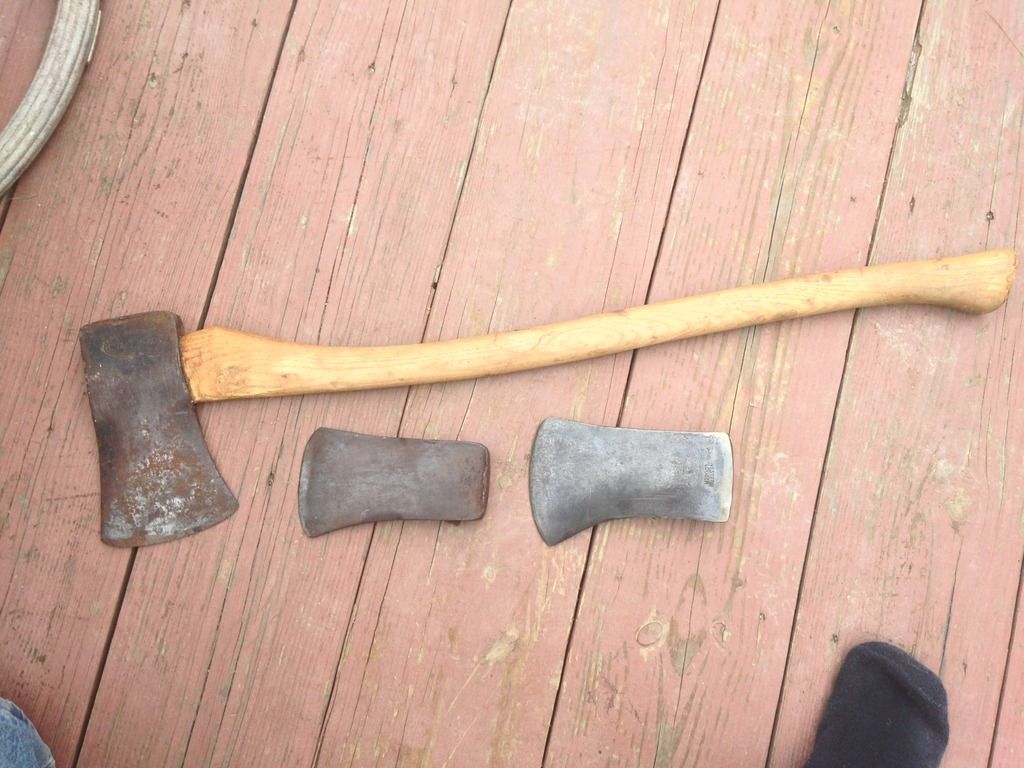

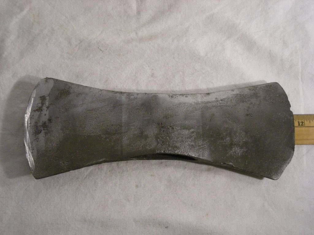

Was out perusing the local antique malls for some antique tools and came across a treasure trove (as the price of a treasure too). Picked these three up knowing they were quality based off names I'd seen before, stamp styles etc. and came up with a handled big ole Craftsman 4-4.5 lber in a pattern I really don't know with a stamp that looked like it might be from the 40s. Picked up a Dunlap (looks like sears, maybe 40s) and one I don't know much of anything on. Heavy, probably 4 lbs and marked Western Logger. Has a good profile, convex cheeks like the other ones but I can't say I recognize the name or brand. I've seen a couple posted on here (I think) but I'm not too sure.

No additional stamps on mine past Western Logger, least not that's left. The other side got hit with a wire wheel pretty good up by the poll but not bad enough to take off any stamps I'd think. Overall the head is about four pounds. It's the only one I don't know anything about, the insanely deep temper like (looks like it almost goes to the eye) and the shape of the head got me interested. Looks almost like a cedar pattern.

That is the classic color of Gransfors Bruk export axes from the 60's (like Stro-Bro GB imports). Remember, GB was the bargain priced import back then. Still good steel.
I'd not mind having a GB import ax, I rather like this theory. The sticker on Mr. Tall's post shows what looks to be "made in ----". The lattering seems to be rather short so it looks like it might be Made in USA? Could be Sweden. Regardless it's got a great shape to it, deep temper line, hard steel, good center line, and a heft weight. Looks like a cedar pattern to me, can't wait to throw some chips once I select a log size for this beastie so I can get to work on making it's handle.

In my opinion the handle in your first picture is perfect. The curve at the knob is not excessive, and there is a slight off-set in the neck. The whole straight handle thing is somewhat of a misnomer. I am a "straight handle advocate", yet my handles that I carve are not straight. They are like that handle. Benefits of the straight handle, and the comfort of the curves.
You know it! For 18 dollars with a handle like that in a head like that I couldn't refuse. Still have to even out the edge (the previous owner used a bench grinder). It's odd to see more wear on the heel than toe. She does chop well though, love the handles like this and I'll probably use this as a basic template for the Western Logger when I Get around to carving a handle out for that beastie.

The steel is more than fantastic and as the image shows: The temper line is almost to the eye. It almost looks to be two piece construction. Weather it's GB or not, it'll be a fantastic axe one it's sharpened and put on a stick.
The steel is more than fantastic and as the image shows: The temper line is almost to the eye. It almost looks to be two piece construction. . .
I've seen a few other pictures of Western Logger axes. They all seem to have that temper line, which I am not used to seeing.

For those who have seen WAY more axes than I have: How common are long bits like these? Manufacturer(s)? Pics?

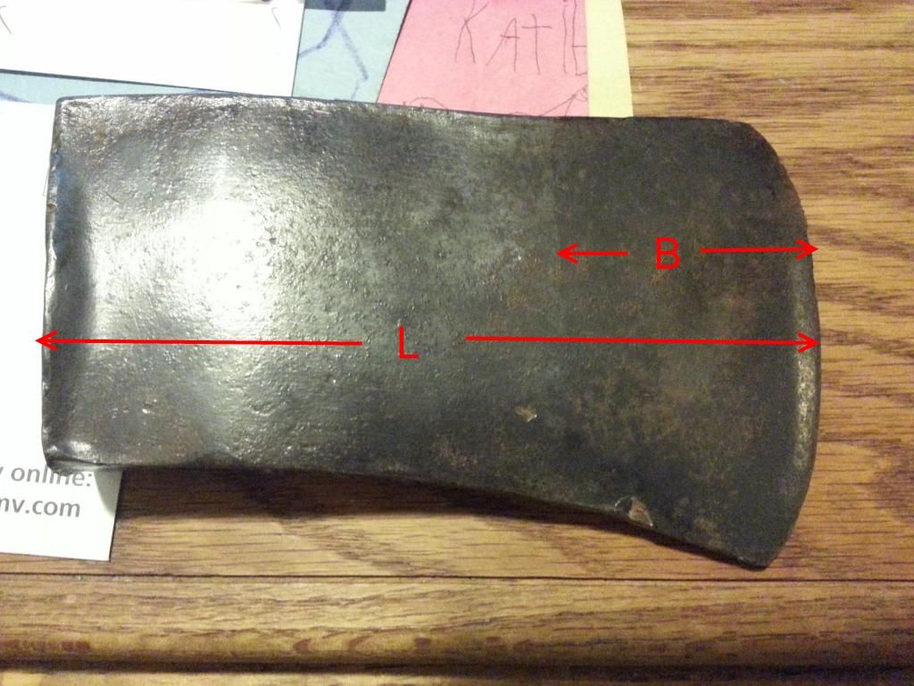

Example of what I'm used to seeing (http://www.bladeforums.com/forums/showthread.php/1245795-Axe-head-ID)

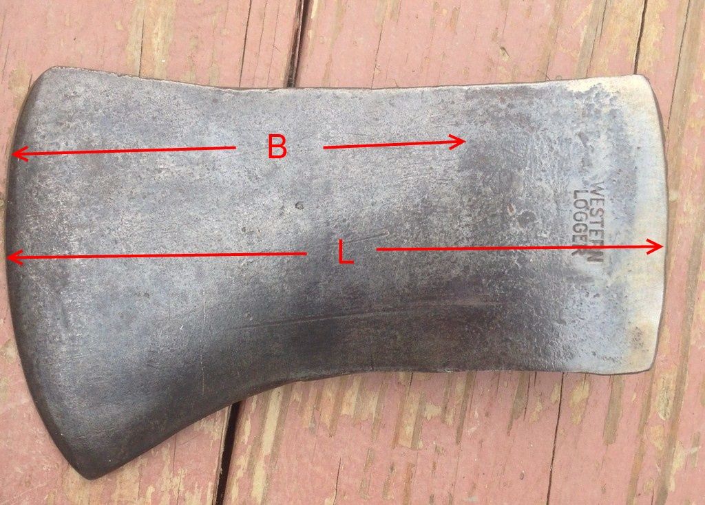

Western Logger in OP
My question is in regard to the ratios B:L in the examples above. Sorry if my question wasn't clear. I'll restate it.
For those who have seen WAY more axes than I have: How common are long bits (i. e. large B:L ratio) like these Western Loggers? Manufacturer(s)? Pics?

I took another look at this label (enlarged), and the bottom line looks like
HARD------ISTRIBUTING CO TACOMA
So, I'm now convinced that it says
HARDWARE DISTRIBUTING CO TACOMA
especially since there was a company in Tacoma with that name, incorporated in 1975.
http://www.sos.wa.gov/corps/search_detail.aspx?ubi=600164136
This would also be consistent with the H.D. CO. stamp on the Western Logger crosscut saw.
Yep! I just made a post about it above, asked a few of the guys on a facebook group for axe junkies and got a fairly speedy answer. Tacoma imported the heads from Sweden and Germany and assembled them in the U.S for distribution at Sears, and Montgomery Wards.
