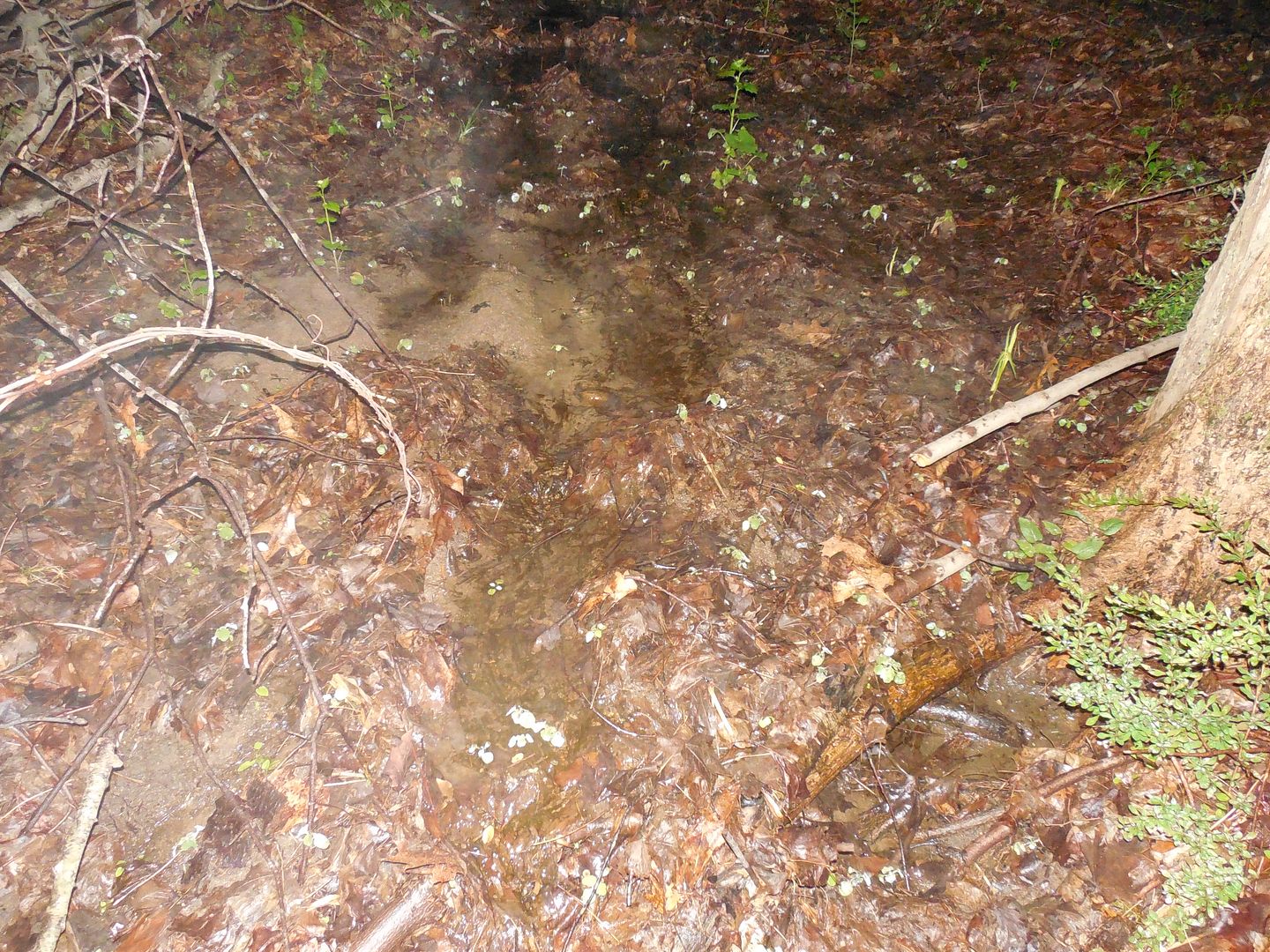

I have never practiced a friction fire in the wet. Figured if it didn't work at the very least this would be some dirt time away from everyone. It rained the entire night before, most of that day and the forecast correctly predicted more rain that night and next day. Haven't seen the sun at all. One hour before dusk I wanted to do a friction fire in a wet environment to practice my skills to learn by doing. Had a bow and bearing block but no tinder or any other fire making materials. I could have made a bearing block out of some standing deadwood Maple but time was short. I felt the odds were against me. But yea never know!
Temps in the 50's dropping into dusk with mist but at least it wasn't still raining. I did pack a poncho but no cordage to resist the temptation of setting up a tarp. I did plan on tossing the poncho over my setup if it rained at the worst possible time like a blanket. Not sure how that would have worked?

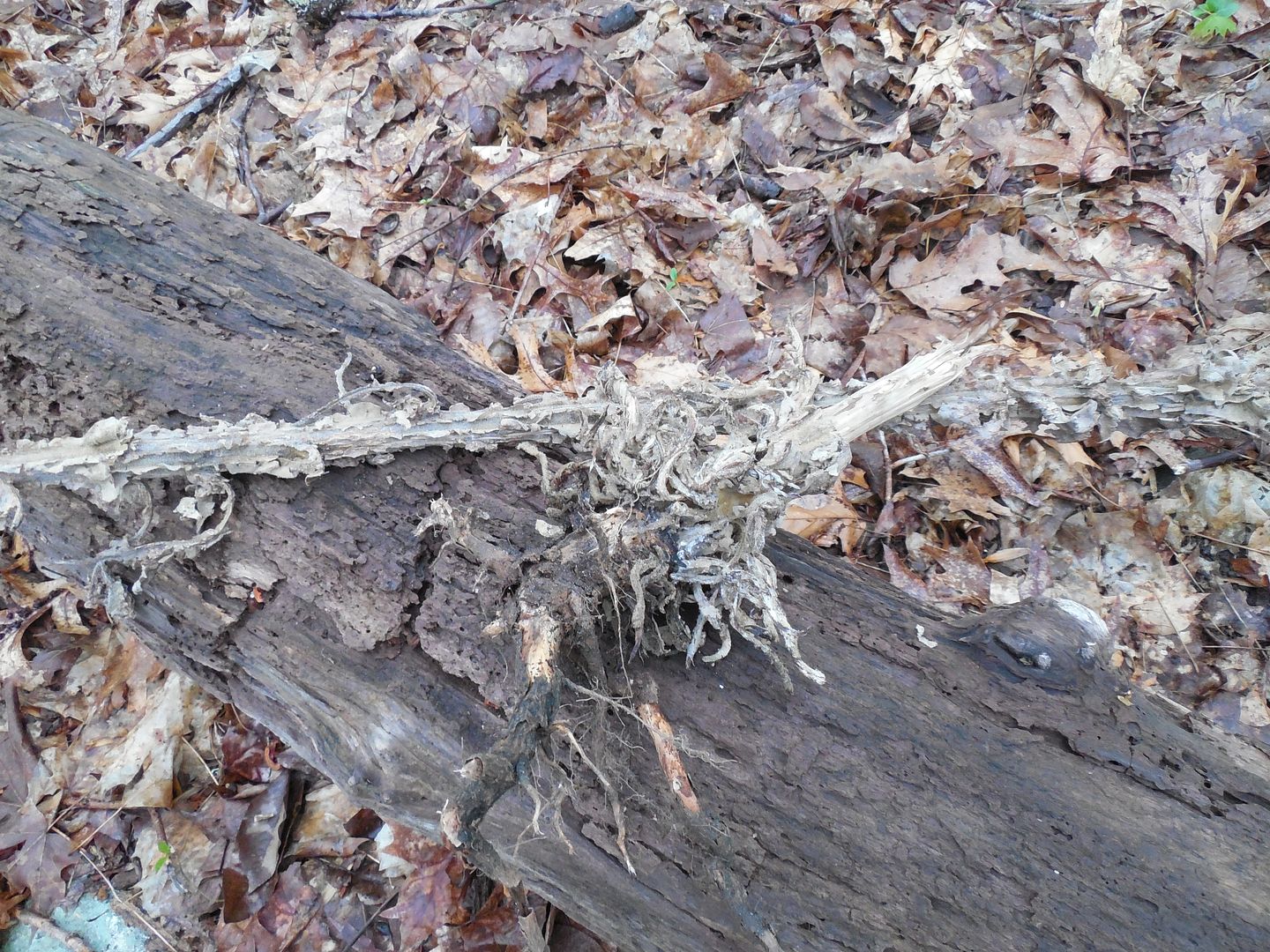

That nasty wet log I was leaning the mullein on had a surprise. The underside was reasonably dry. The spider web was my first clue. That and the dry leaves. LOL! There was some dry punk wood inside. A little too punky but I wasn't in any position to be overly picky.

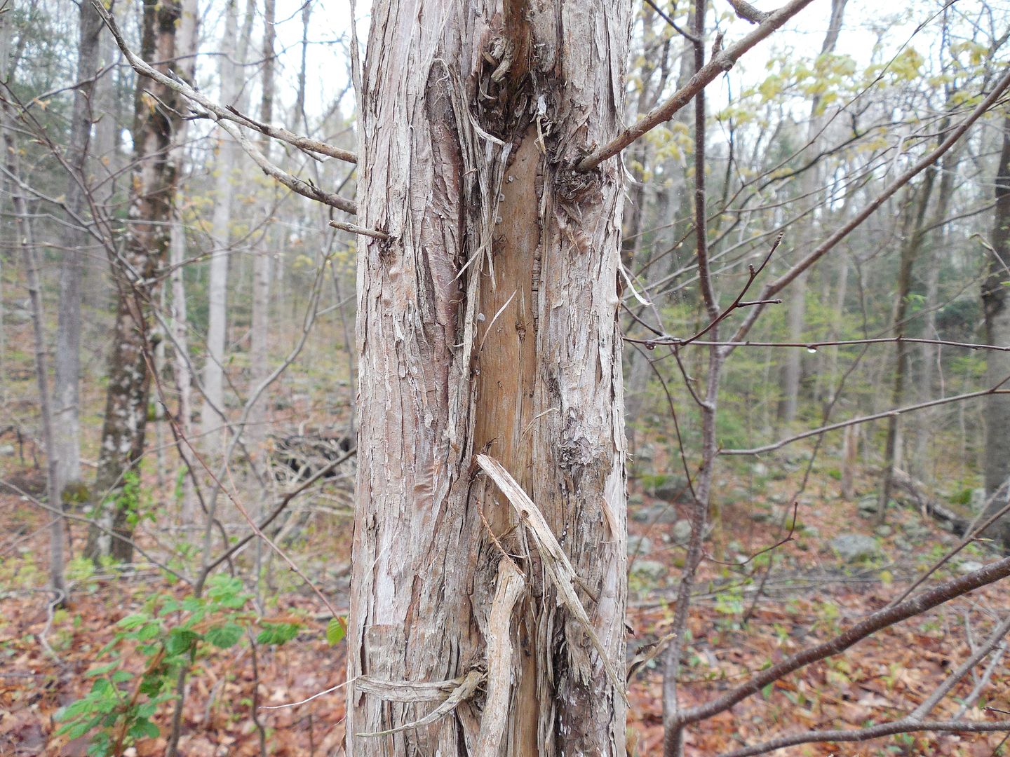

A small cedar. There was a drier area on one side of the tree lower to the ground. Got on my knees to scrape some bark with the knife. There wasn't much available but it is what it is.

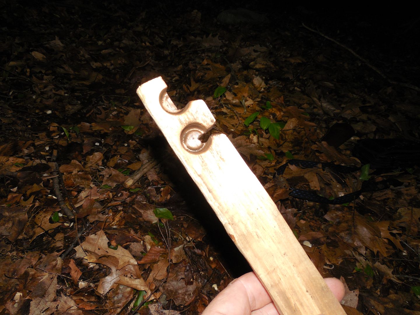

I still needed to make something to keep the fire board off the damp dirt ground. Using "batoning is evil" methodology made a board a bit wider than my fire board but around 3/8 of an inch thick. Too thick and it might make the fire board hard to keep upright. The other piece could be worked into a backup fire board. It was cut from a thicker section of the (hopefully) White pine branch. The insides might have more or less moisture content. I know how to check wood if it is dry but not enough to distinguish smaller percentages which may or may not make a difference here. Not sure but a backup option is always nice.
I also made two spindles, one of mullein, the other White pine. I have no idea how to make mullein drill into a board during a burn-in. For the life of me I couldn't do it however pine will. So the burn in was done with a pine spindle of similar size. I did have to monkey around with the mullein some to get a good fit. Two different spindles = more options at a minimal cost in time or energy as the same materials which make up the fire boards and coal extenders are also used for the spindles. The burn-in had lots of smoke feeling somehow right. The V cut was a bit off center and maybe could have gone deeper IMHO but so be it.

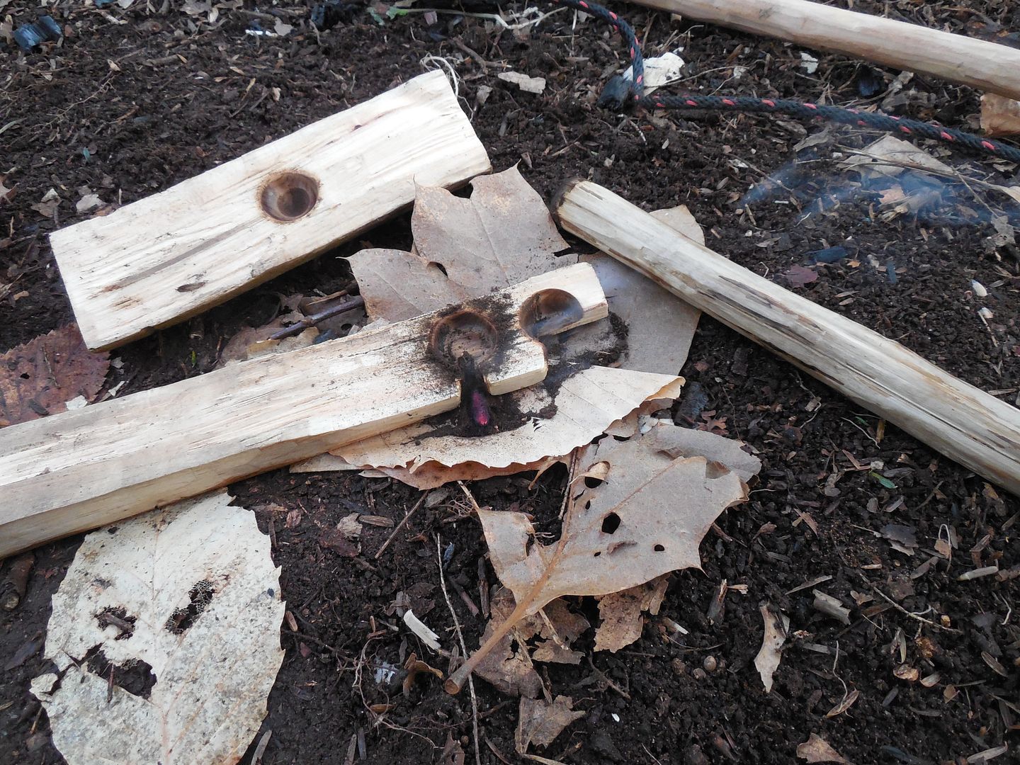

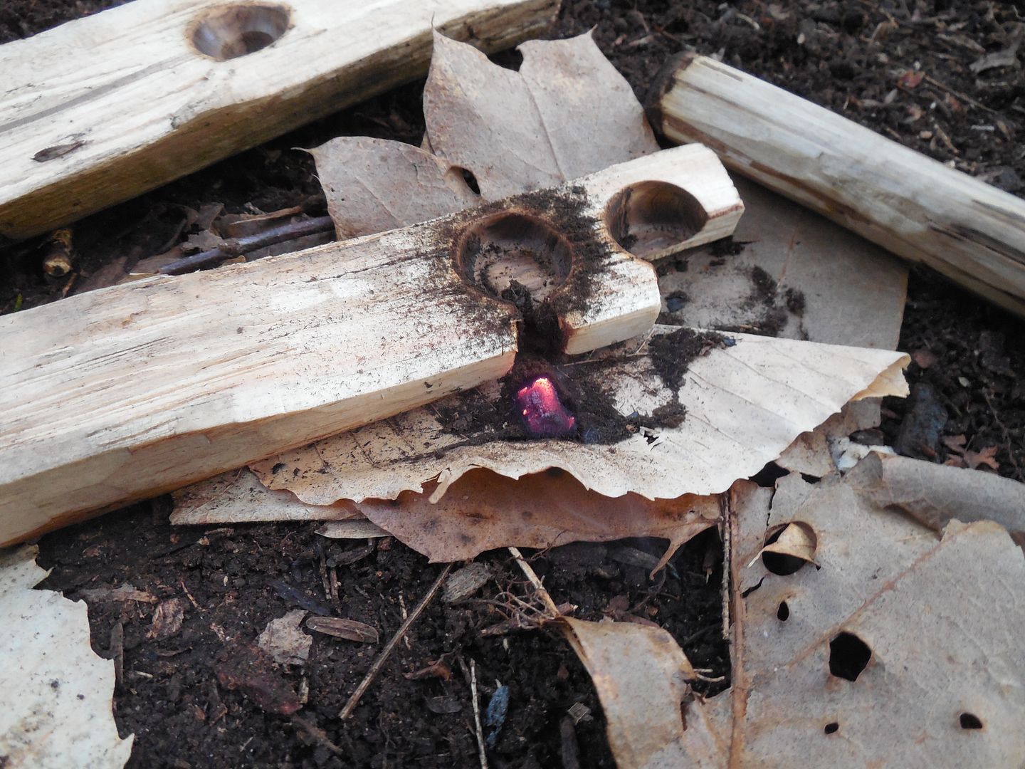

GO! To be honest it looks cleaner in the video than in real life. Needed to cut out a failed attempt, smoke and dust but no coal. The readjustments of the mullein spindle for size also cut. When I tried to do the burn-in with my boots the fire board started to tip so those minutes were cut. I didn't think people would want to sit through an extra 20 minutes of video till I got it right. The thin board did keep the fire board off the damp soft dirt. Also kept it from sinking. The other thin pine shaving/board held the coal on a dry insulated surface which probably retained some heat from the bow drilling. Sure someone has done all of this before as there is nothing new under the sun but was happy this fire board setup actually worked.
The tinder bundle took off well once the extra mullein pith and punk coal extenders caught. The punk was past it's prime but worked. The pith worked well. One nice thing about coal extenders is they give extra time. Once they catch the feeling of urgency drops.

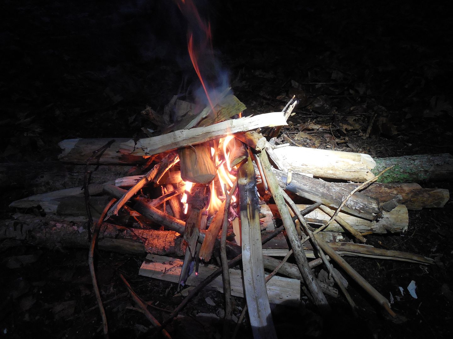

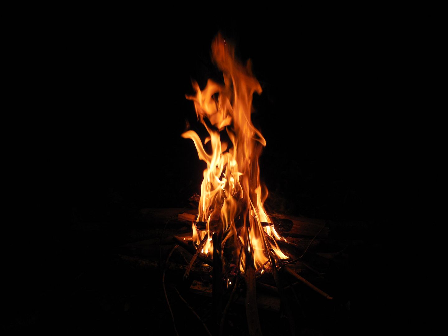

Tossed on the fire board/spindle scraps. The kindling was inside the tree nook so was one sticking it at first gasping whatever was near. Not really ideal. Despite being in a dry spot in case of rain in retrospect I should have taken the smaller kindling near the platform. Also the platform could have been larger. I knew better on both counts. The birch bark and coal extenders compensated for my shortcomings.
Tossed in the rest of the friction fire makings and some kindling. Looking good.
Success!
The leaves near the fire are starting to dry. Zero chance of a forest fire but moved the leaves farther back. making sure the fire was totally out when done.

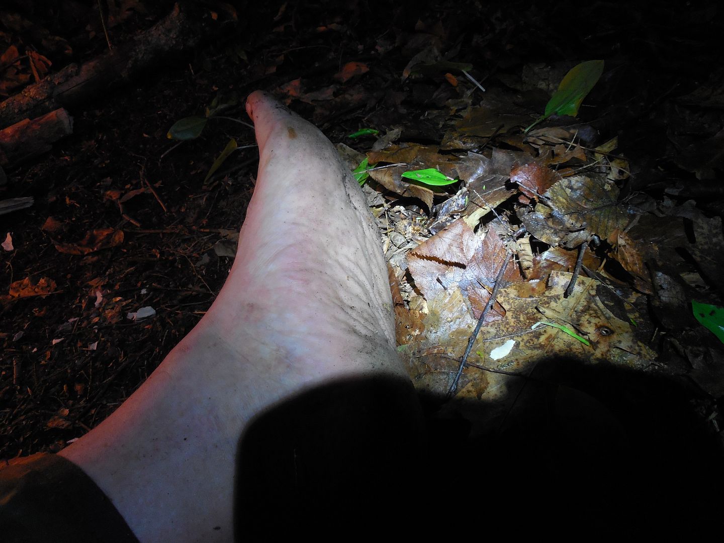

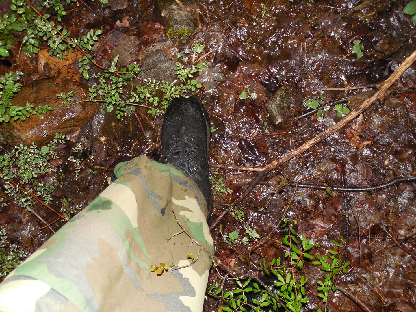

What? No hiking shoes?
I had some difficulty using my boots on the soft ground with the insulator and fire boards. This was actually the driest spot around so really couldn't move or come up with another idea. Then again I have used bare feet before so maybe the issue is with me and others could have used their boots perfectly fine. Don't know but did what worked best for me.

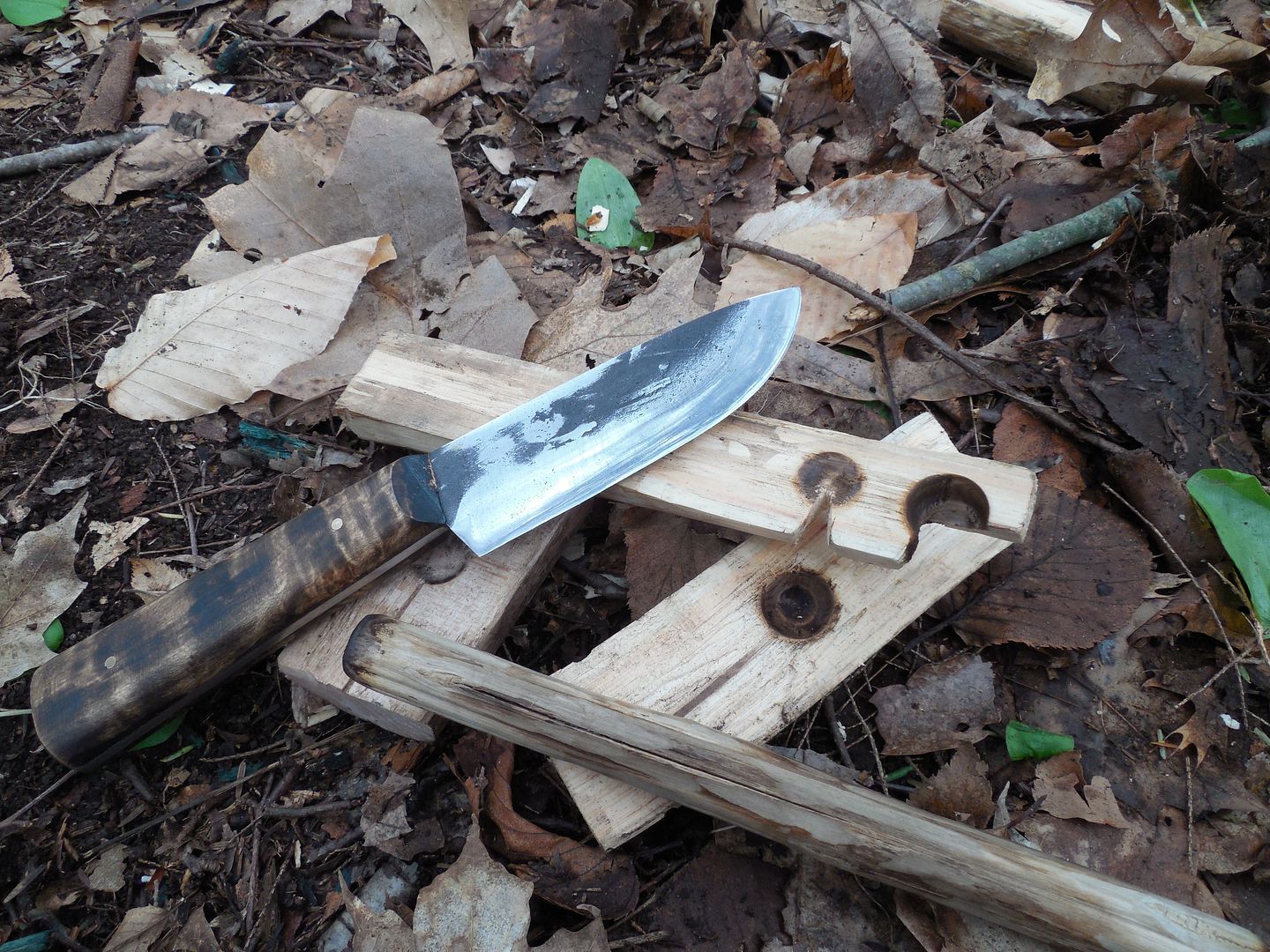

Cutting tools and newly made kit.
1. Corona or maybe it is a Felco folding saw. Own them both.
2. Last of the BHK "Ranger" knife on a test run. Just got it!
3. Robert Jones/ Jeff White Bushcraft knife.
4. Newly made White pine fire board with mullein spindle. As a proven fire board spindle combo if kept dry this is now a kit item like a Bic, matches, F&S, fire steel etc etc. I could get a bunch more fires out of this if needed.

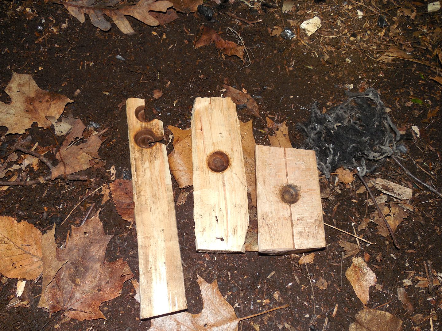

I was wondering if the shot glass bearing block gave an overwhelming advantage. So I returned the next day at the same time with the same materials. Made bearing blocks of both rock hard maple and soft white pine. Got coals with both. We had a shower during the day but the air felt noticeably drier. Still it would have worked just the same.
