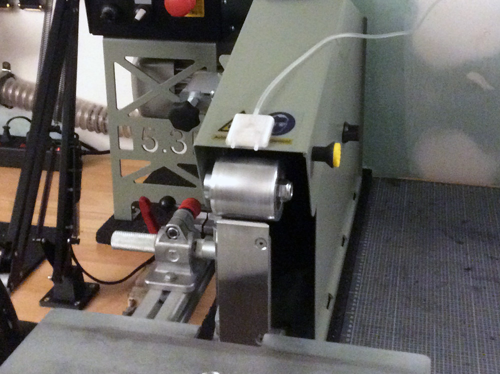

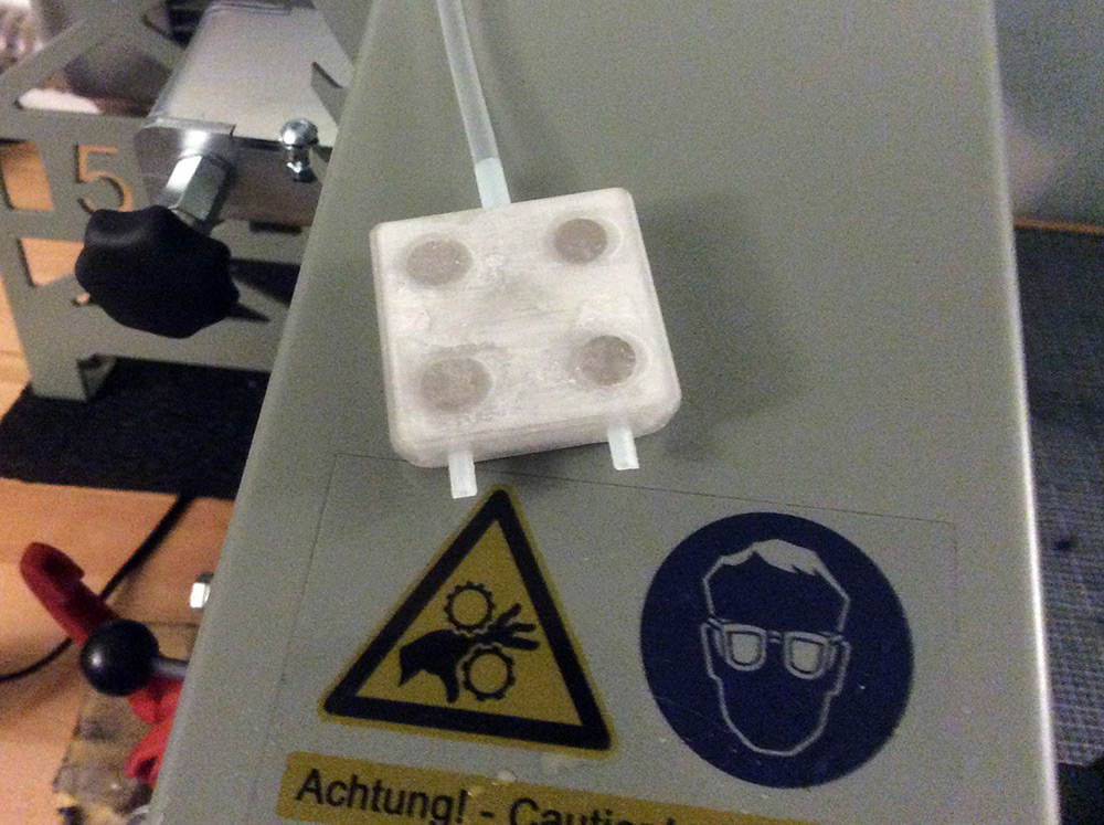

Hi all,
want to show you a small and simple but effective working way i constructed and 3D printed for my grinder. BTW, I print with PETG only so this prints are really tough.
A simple solution for wet grinding, it is attached on top of my grinder with 4 magnets which are inside the housing.
This dropper can be regulated and is made for standard 2" wide belts.
What you all think?
On the grinder in place:
Backside, showing the magnets:
And some vid showing it in action:

He's grinding on titanium so the belt speed is really slow - not much spray. At high speed it would be flying everywhere! 😆

Thank you for the advice on the kool-mist. But the drop/drip method works just fine for me.
Like Mecha said, i am grinding very slow, at 20-30% speed of the max speed of my grinder (max. speed is 22 m/sec).
Additionally, my grinder is in a closed housing, all parts are either stainless or industrial grad paint coated.
I can tell that about 99% of all dirt/dust is inside the grinder housing and the most of it is sucked out into a heavy duty steel cyclone/barrel.
With the water droper the mess inside is not really a lot worse then grinding dry, it's a litte wet on the bottom of the grinder and that's it. Since i clean everything at the end of the day it's no big deal.
BTW i also made one with 4 droping outlets instead of 2.
I really doubt that i use that much water a year too, but to each his own.

Thanks Fred, but keep in mind i grind heat treated Titanium only at very low speed but with lot of torque.
I sharpen everything by hand on wetstones, freehand.
The blade is more or less completely covered with some water when grinding, i also dunk it after each pass and i only use 3M cubitron II belts. the blades are not literally but really only hand warm even if ground thin.
I DO NOT grind steel. This thing i made just works fine for me. I don‘t see the need for a mist system at all. It don‘t work for you which is perfectly fine. :)
