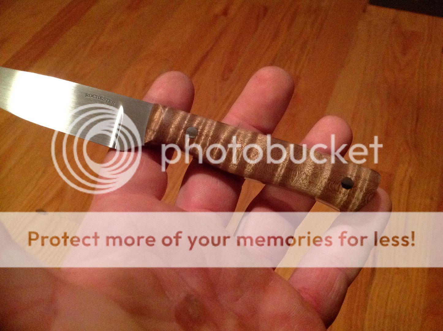

So, a while back I was having some issues finishing some ivory micarta. Someone here told me to wet sand it with wd40(thanks to whoever that was!). I did this and it worked perfectly. It got me thinking if I could do this with other materials like stabilized woods. So I just finished up a batch of 8 Bird & Trout knives with stabilized curly maple and used this technique on all 8. I went from 60,220,400,800,1500, and then buffed. It worked great and seemed to cut down on the finish time. Is anyone else doing anything like this? I was wondering if it could damage the integrity of the stabilization? I do clean them off with windex before buffing.

Maybe my post is a little misleading. I was just sharing a tip I have used on other materials and did use on these last few. I was wondering about it damaging the stabilization but that seems to not be an issue. It helps my paper stay clean and last longer. Also I seem to be able to finish a handle faster. I am not leaving the oil on it or using it to make the handle look better either. I clean the oil off and then buff. Just thought I would share this but it may be common practice for others. Just seeing if anyone else did it this way.

Essentially yes. I think it does work better as it seems to hang around longer. I guess a little of it is being absorbed but it doesn't feel oily and yes I'm removing it with the windex.
