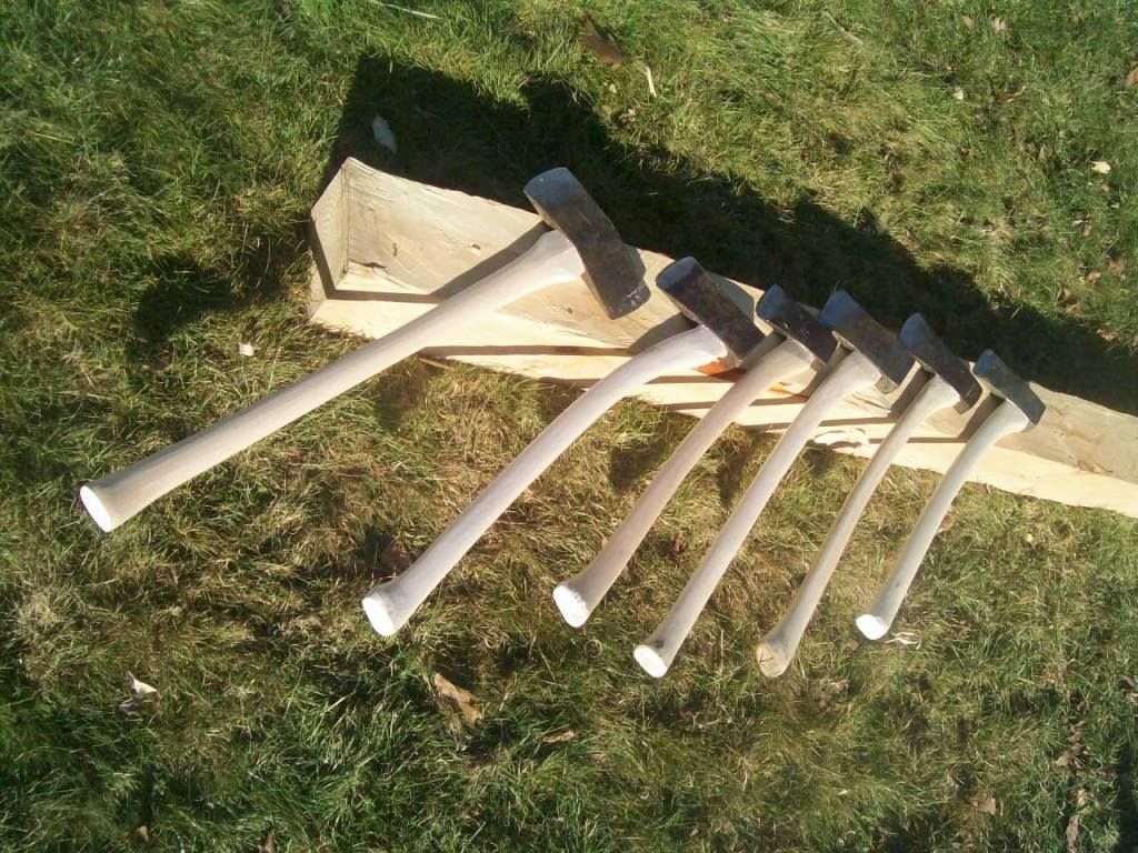

I prefer something like this for cross grain chopping in softwoods:
Just don't want the "thin=chopping thick=splitting" paradigm to go without a little questioning, even though this is an old thread. Whether an axe is set up for splitting or deep cross grain penetration has more to due with the first 3-5MM of edge in relation to the profile, than the entire top down view.
Whatcha got the forgetsies? I posted a picture of it with 5 others not even a month ago!
Nah, I was just messing around. I figured the zombie thread was a good place to dump some worthless tomfoolery.
So is that double bit the one you were going to send to me???
