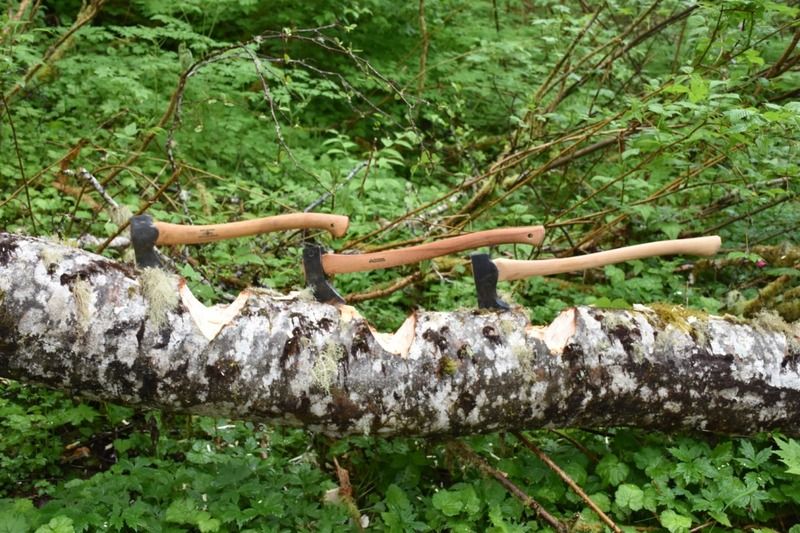

I have just gotten the Wetterling Hudson Bay from Lumnia, so I wanted to give it a try. I decided to compare it to the Gransfors Bruks Small Forest Axe and the Council Pack Axe. All are about the same size, but there are big design differences between them.

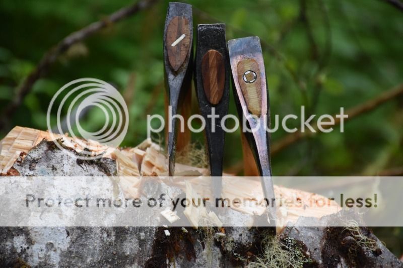

First, the GB SFA is smaller, with a 19 inch handle and a thin head profile. Both the WHB and CPA have 23 inch hafts. The WHB has the thickest profile, making it better for splitting.
But I had a downed alder in the front yard, mercifully suspended at a little less then waist high, so I didn’t have to kneel in the mud.
I gave each axe a shot at cutting the alder in half, alternating axes after 10 blows, with each cutting their own Vee.
The WHB had the poorest penetrating power, which is to be expected with that head profile. The CPA was better. The GB SFA was the best for penetration.
As expected, the longer handles on the Wetterling and Council made a difference in terms of power swings. The Gransfors Bruk SFA was lighter and easier to use.
They all performed about the same. The GB SFA cut the smallest Vee. The Wetterling Hudson Bay was second. The Council Pack Axe cut the deepest Vee, but all were close.
None suffered any edge damage. Heads all remained tight.
Here are the axes: GB SFA on the left, Wetterling HB in the middle, Council pack axe on the right.
Same order. You can see the GB has the thinest head profile, and the Wetterling has the thickest.
