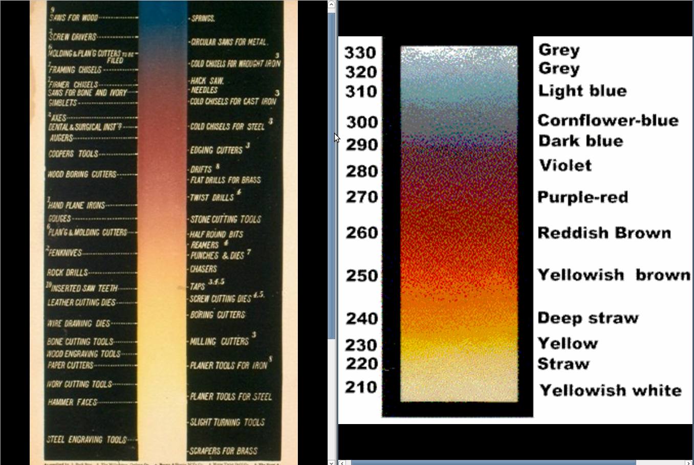

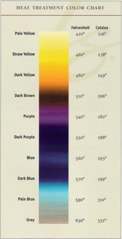

It strikes me as interesting the the hardened axes are tempered at only 195°C (383°F). That's a very low temperature for tempering an axe - still in the yellow/straw color range. I'm surprised that it gets down to RC 57 at that temperature. Higher carbon steels would require tempering to about 500°F. So this steel is at close to its maximum hardness.
Gransfors does a similar heat treatment as Wetterlings.
I think the key phrase is "based on C55", but it is alloyed a bit. That allows higher final hardness, I.e., not drawing the temper as much, with better toughness than pure carbon steel. I believe I can feel a difference b/t carbon steel and e.g. 5160 when filing. The alloys feel " dead" and seem to catch the file. May be my imagination, though :).

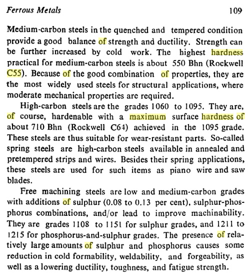

Thank you. I bring this up because I wish to dispel some people's application of mystical properties to Swedish medium carbon steel. I know you're not in that group, Steve. Your post is just a good lead in for me.

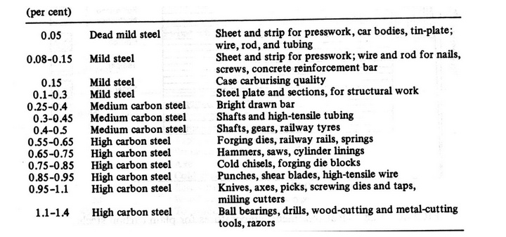

C55 steel is at the borderline of medium carbon and high carbon steels. Some classify it as one, some as the other. But it's much lower carbon than was used to make axes in the past.
There are different ways to producing an axe with mid-50's RC hardness. Hardening a medium carbon steel to near it's maximum hardness is one way. Using a higher carbon steel and tempering it back further is another. Both have the same hardness but the higher carbon axe will have the great wear resistance.
Link
US Forest Service specs called for a minimum of 72 points of carbon for an axe bit. But axes of yore often exceeded that. Agricultural steels like 1080 or 1085 were used. 1095, a common knife steel was used. Even higher carbon 'razor steel' was used in some axes. Sears advertised their 'Fulton Razor Blade' axe with it's high carbon steel.
