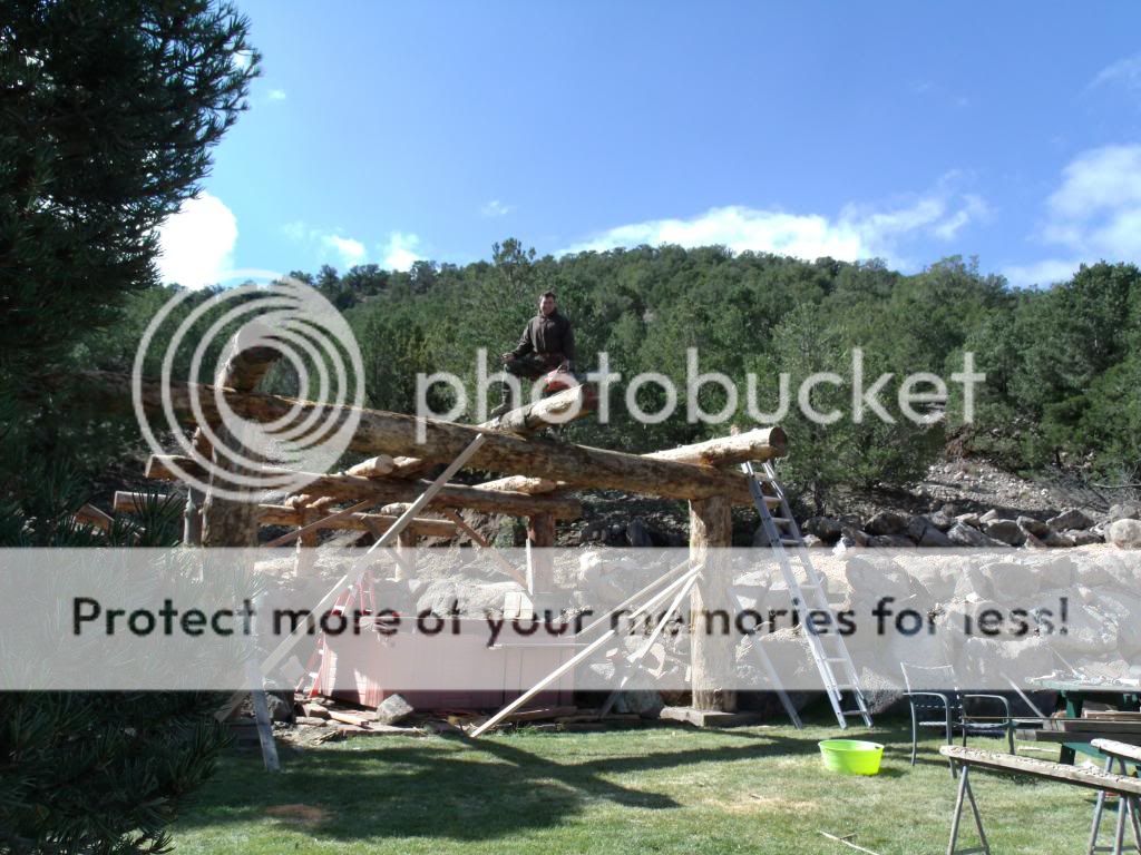

I have that same saw. Bought it in '07 or '08. It's a great saw, has done a ton of work, always starts. Elevation of this photo 7200' most of my work is between 8 and 9000' and mine runs just fine. Bought it locally maybe the carb jetting is regional.

Awesome pics!!! Looks like your saw was/is definitely earning her keep!
