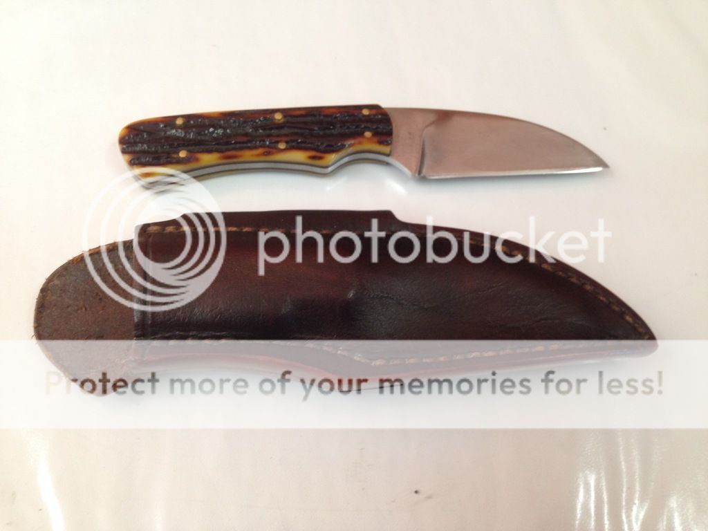

This was the first knife I ever made, and the second sheath I ever made. (can someone using a computer tell me if the pic is really large? My phone resizes it. Thanks!)
You can see that, worn on the right side, the sheath looks backwards because of the shape of the knife.
Post any pics you might have of a sheath you made for a wharncliffe, I'd like to see how you guys do them.

I have made quite a few Wharncliffe sheaths and they are nearly all pouch style. They look pretty much exactly like your example. In my opinion you are doing it right, following the blade shape. As fa as looking backwards when worn, I don;t see that. It is what it is and you are doing it right.

Yea, I've made a few. And yes, it always looks backwards to me as well. :D
Most of mine have been Randall style with stitching on both sides and wet molded. Makes the backwards effect look that much more standing out.

Paul, thanks. Definitely feels good knowing you see it as correct.
Lytefoot, very cool knife and I like the shape and construction of the sheath. Thanks for sharing it!
