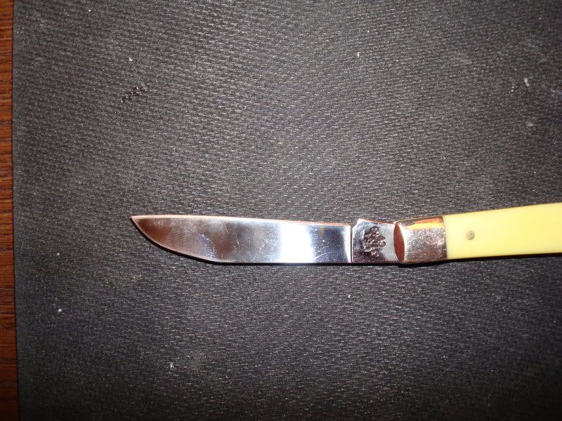

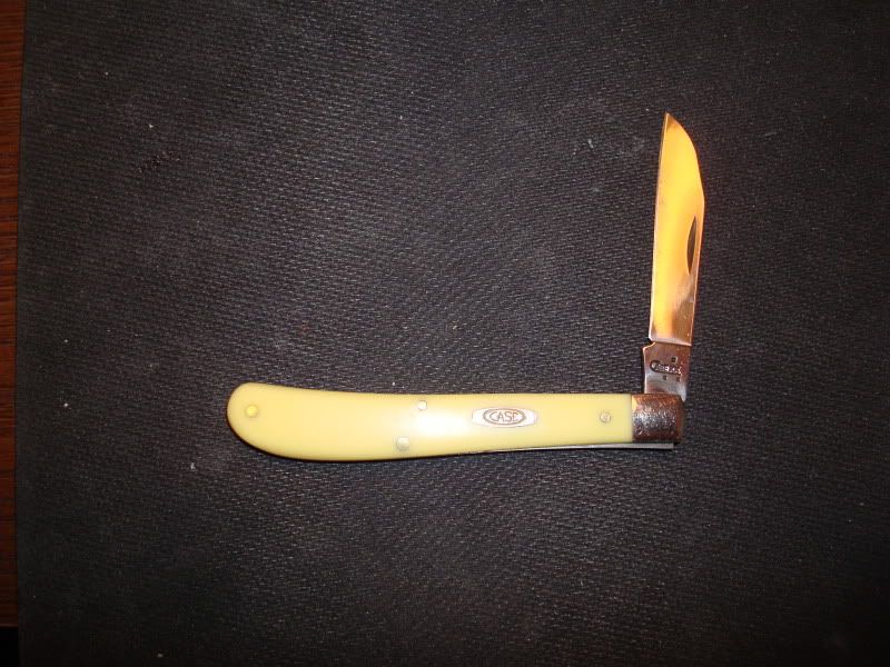

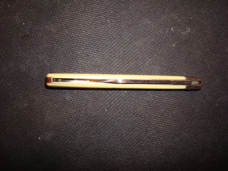

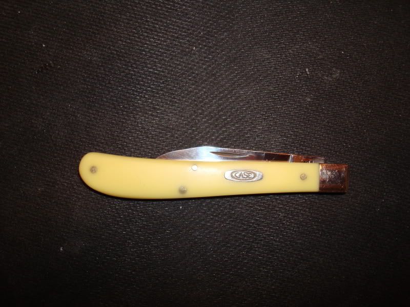

I love the feel of the Slimline Trapper in my hand. The long slim handle is great. Disappears in the back pocket too. I just didn't need the blade so long and delicate at the end. I wanted a shorter, stouter blade. I really like carrying and using this knife now! I wanted to get the Victorinox Gardener a while back. I'm glad I didn't because now I have a similar knife but in CV!!! I love that I can pinch it open also.
Thanks! I used a cutoff wheel on a Dremel and a lot of water. Taking real light quick passes. Finished it up with a file. I put the blade in a vise to hold the knife.

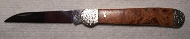

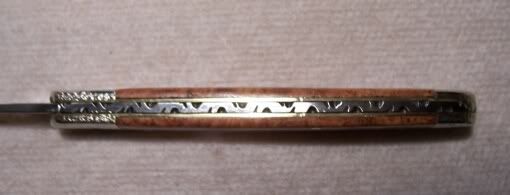

This is the Copperhead w/Wharncliff (6249W CV), with the clip blade removed, amboyna burl scales, and custom file work.
