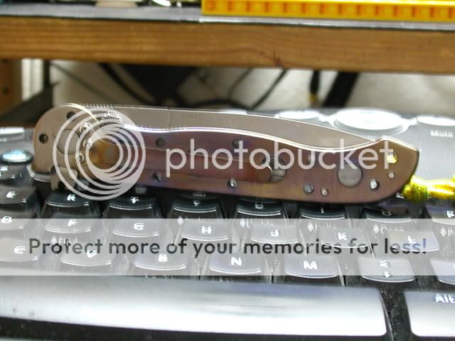

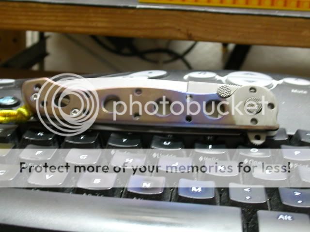

Two ways to anodize titanium, electric and heat. I have done some heat on my M16-13T folder. For the electric anodizing you have titanium in a bath of pepsi (electrolyte) and you hook up a variable dc source to the piece and to a sacrificial anode (cathode?) and 0-100 vdc produces different colors. Here is my flame (heat) anodized m16
Heat coloring is not anodizing. Anodizing requires the use of current, anode, and cathode.
Bill
