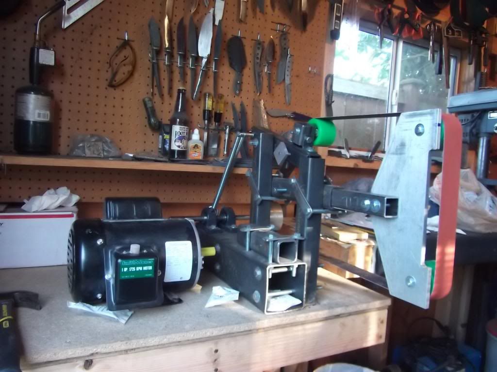

So I am just about finished with my NWG belt grinder except I need to wire the motor. This isn't really a question about how to wire it (even though I'll probably end up asking for help with that lol) as it is a question of what materials (light switch box, wire? etc.) I need to buy in order to get it wired.
I know pretty much everybody used a light switch box for an on/off switch so I'm assuming that will be one thing I need to get, but what else do I need in order to actually get it wired up to a "plug" so I can, well, plug it in! ;)

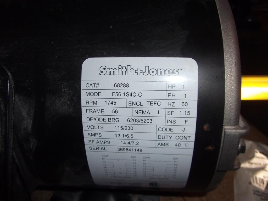

My motor is a single phase TEFC 120v 1 HP motor from Harbor Freight, the Smith & Jones brand. So anyway any help would be greatly appreciated as so what I need, like a list, and whether or not that can all be obtained from the same place like Lowes or Home Depot. Thanks to everyone in advance! :) -Paul
Here are a couple pics showing my motor, it's specs and my grinder setup in case these help you to determin what I need for this particular motor...
I would use a PVC switch box, not a light switch box. It will be sealed much tighter against dust. Use a switch rated at 20 amps. Use a pigtail (power cord) rated for 15 amps of more, which should be at least 14 gauge. 12 gauge would be better. The wires from the switch to the motor should be stranded 12 gauge with solidly crimped connectors that match the motor lugs. I would use crimped lugs on all connections. When wiring a device that draws the current a 1HP motor does, you don't want to be just wrapping wires around the screws.

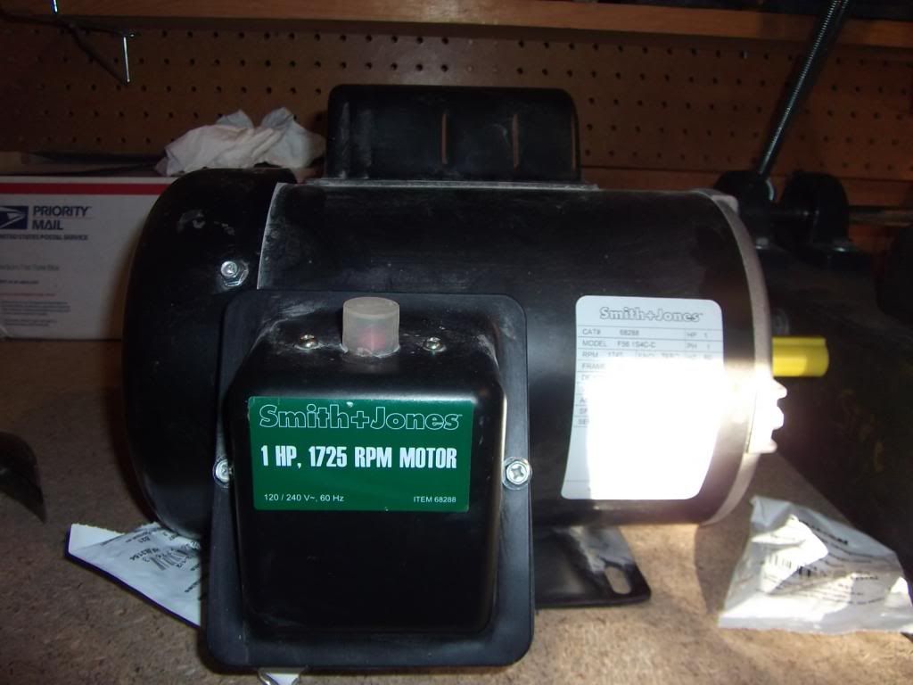

I'm confused as to where on the motor the 14-12 guage cord would go, I mean do I drill a hole into the wiring box on the motor so that it has a place to come out after being wired to the motor and replacing the box that coveres the wires on the motor. Or actually, do I drill 2 hole in the box? one for the plug, and another for the cord connected to the switch?
Feel free to jump in here as well Count lol ;) Or anyone else for that matter. I kinda need to see it to understand it. I see other nwg motors which two cords coming from the wiring box on the motor, one for the plug and the other for the switch but it looks like there was already a place for the cords to go through.

When you say the motor has a hole for the wires to enter/escape, do you think you could tell me where these hole are by the pictures I posted above? I see there is a button on top on the wire box, which I have no clue what its purpose is.. do I remove that and use a a "cable gland" (same as a cable clamp?) to secure it through that hole? Or is that button important?
Also, That takes care of one hole for the pigtail cord, assuming that's what I would do, so where would the cord that attaches to the switch enter the motor wire box?

Start by taking off the cover to that box
Have a closer look at that button and see if it says reset on it or something
See if there are some wires on it.
It should be really obvious
I think it's a circuit breaker.
In this photo, you can see a circle in the photo on the left beside the cord
The motor manufacturers put punchouts there, so it will come out with a hammer and punch.
Since your motor is a HF model, they may have skipped that and you have to drill 2 holes, one for the cable gland to run the cord in.
One hole for the switch to mount in
I think that the button is the motor reset. There should be a hole, you might have to knock out a coin looking thing, that the wires go through. It should be on that little box that the button is on though. The other thing, that motor is 110/220 volt. You have to change a cooper wires around to make it one or the other. Not sure which way I came wired. The power comes out of that box and into the PVC box, and the pig tail comes out of that into the plug in the wall.

I'll bet that your dad, if he is indeed very knowledgeable about wiring, will be able to figure this out pretty easy. That screw off cover on your motor should have a diagram on the inside, with wiring instructions for high and low voltage connections. Usually there are several wires, 6 often, that can be combined in different ways to each other and to the lines in, for your voltage.
