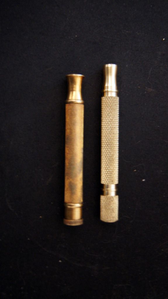

It was a last minute failure:( I decided to make a stainless handle for one of my Gillette 3 piece razors. I had it all turned, knurled and polished, just had to clean up the bottom end where the center holds the work steady. Well I put a touch too much pressure on it and broke off the threaded insert I made to hold it without clamping the chuck on my finished work. I figured no biggy I can just drill it out and chase the threads again, wrong. I broke the drill bit off in it and it leaves me about 4 threads short of being able to tighten the head down:grumpy:
It still OK because I am started another one today, only in brass this time. I really need to get some other options for knurling though, the one I got with the lathe it a bit industrial. I know there are decorative ones out there I just have to find the right one.
Well I sot of got one done, I still need to polish it, and the knurling is still an issue for me. Right of the bat the only knurling tool I have gives a very heavy looking knurling, then just as I was starting to do the knurling the auto feed let go on the lathe. I sort of got it fixed temporarily, but it needs to be fixed better. I know how to fix it, but having the auto feed working would make turning the new part a lot easier. It is the section of knurling right at the end of the handle where the auto feed let go. It is a little faint and because it rolled over on itself a couple times before I noticed it didn't get a nice diamond impression. Its OK because its not like I plan on selling this one, but I am going to use it in about 30 minutes. Shes a heavy one compared to the original handle, added 10 grams to the weight of the razor.
Old Probak on the left New homemade handle on the right

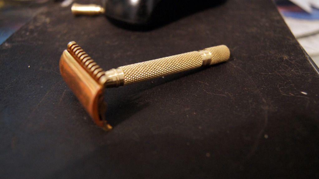

New Handle with Gillette Goodwill head
Not sure what head I am going to try first with it, the Goodwill is a bit on the aggressive side to add 10 grams too. I might give it a go with one of my older Fat Handle Techs or an Old Type head from a Ball Handle I have.
I think it is really cool, but if you want less aggressive knurling, chuck it back up and use some fine sandpaper on a block to take the tops off of the checks...if you progress up to really fine grit, you should be able to get a cool look to it also;)

Its not a thing of less peak on the diamonds, its the size of them. They are about 1/16" across, I would like something smaller for razors. If you look at the picture of the new and old handle together you can see how much finer the original handle's knurling is. its not the clearest picture, but you can sort of see the size difference.:o

Oh, I can see the difference, but I guess I just like an aggressive grip on sharps that I handle with wet soapy hands.
