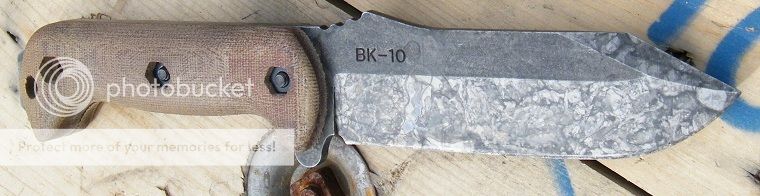

I was wondering if anyone knew what kind of finish this is, and how to do it at home possibly. Thanks
Lots of people on the Becker forum have done their own patinas, you can search there for the details. Beckers are carbon steel and come with a black coating. They strip off the black coating, clean the blade, and put it in various substances such as mustard that will attack the blade and force a patina. The patterns of this "stuff" that they put on the blade are what create the patterns in the patina.
