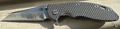

So I recently traded into a RHK xm 18 3.5 Slicer grind no choil. It has since taken over my pocket. And I use it daily at work, time to touch it up. Wondering what folks tend to reprofile these to, the factory angle seems very obtuse to me (especially for something called a slicer). Using my angle cube on a zeroed out kazak model 100 looks like the factory angle is about 25.5. So what do you fellow blade addicts think dps wise 20? 18?
Mine is now at 17 degrees per side. It didn't really live up to its slicer name, though, until I thinned it some, to knock back those fat shoulders.
Any chance you could post up a picture, I would like to see it.
