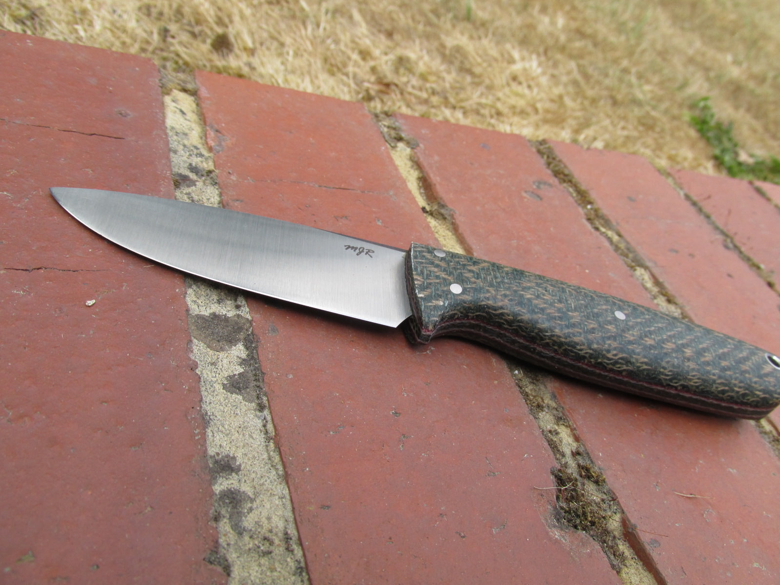

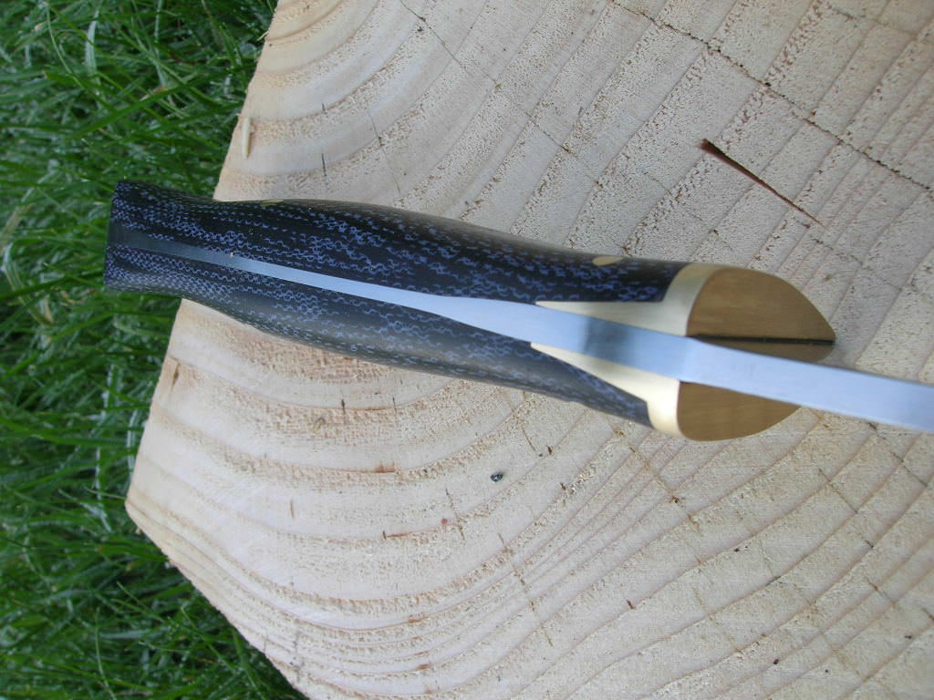

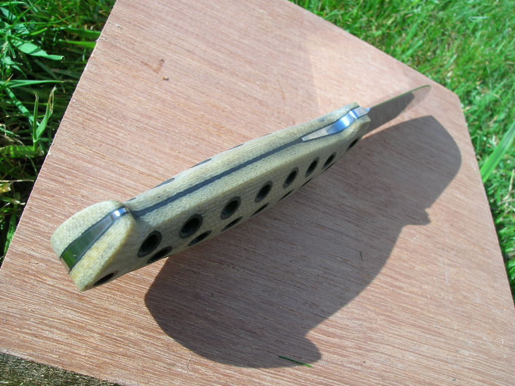

Not sure if it counts as new or up and coming as I have been doing it for a few years.
Moulding home made micarta directly onto a knife tang. It is easy to do and opens up a whole range of possibilites. All sorts of taper tang, half tang, stick tang, pretty much any tang shape you want. You can even put the plunge under your scales for a real clean simple blade.
A few pics showing some of the things I have tried. It would be good to see some others using this technique.

Thats pretty cool Mike! So do you press with the blade sticking out of the micarta press? Or just wrap it up tight and do a lot of cleanup?

For bolsterless knives I put layers of cling film between the blade and the laminate so when it is cured you can pop the scales off , clean up the front edge and glue and pin them back on.
For bolstered designs I have covered the blade and front edge of bolsters with release wax and cling film and then pressed the laminate directly onto the tang. Obviously the bolsters mean you dont need to clean up the front faces of the scales. If you design the knife carefully the scales will bond together through or around the tang so you dont necessarily need pins. If you do want to fit pins you have to drill oversize pin holes in the tang and then take care to drill pin holes right through scales and tang in the correct place. I havent done many bolstered knives.

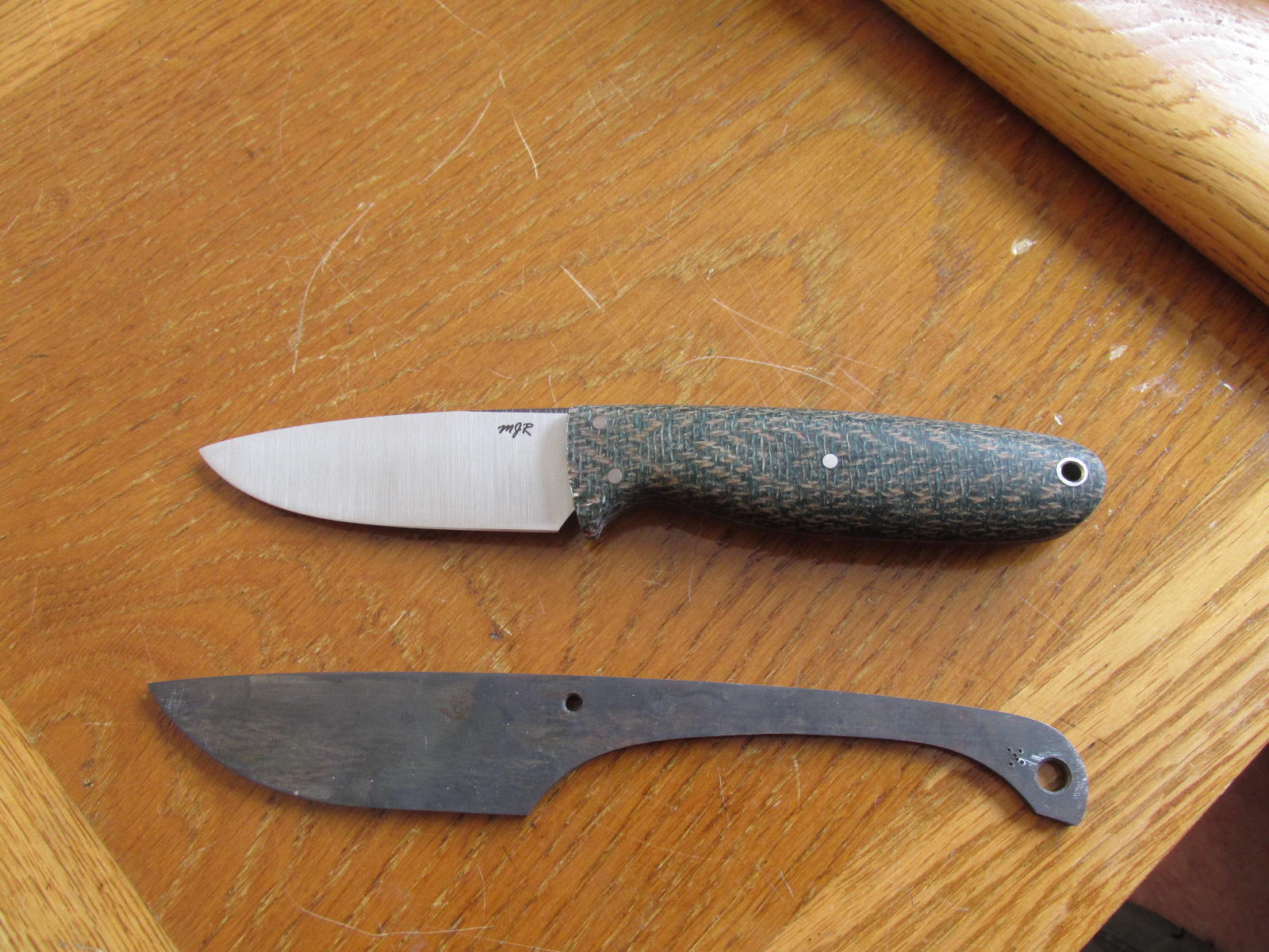

I did a tutorial many years ago on the now defunct British Blades. I keep meaning to do another but never get round to it.
The first one starts with a blank like this:
The main bevels are ground with the plunge just in front of the front pin hole and the tang is tapered. It is then pressed between two slabs of home made laminate with cling film to stop it sticking. When it sets, pop the scales off, clean up front edge, glue and pin back on and shape.
It is very easy once you have the micarta making sorted.
