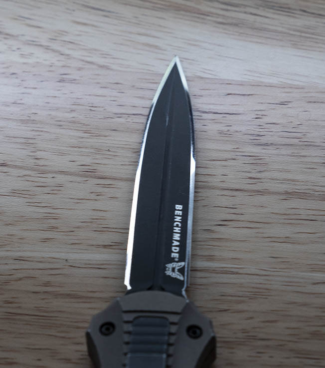

What are the best sharpening tools for high quality OTF knives?
So this is what I’m asking…you would use a whetstone for a kitchen knife. Would you use that on a Elmax, M390, CPM s30V? I can understand it may not matter on high carbon or VG10 but I bought some expensive OTF knives and I have no interest in marring or damaging the blades. I was wondering if an electric work sharp, senzu, etc would be best. thanks.The exact same sharpening tools used for every other kind of knife.
I’m not a skilled sharpener as you are. I was actually just wondering if there was an easy electric style sharpener for amateurs like me….If you are marring or damaging the blades then it is your manual skills - NOT the tools you are using. I sharpened knives for a living for years and all I ever used were Norton India stones, Washita stones or diamond stones. I don't quite understand why you think a specialized stone is needed to sharpen an expensive OTF blade.
Gotcha. Thanks drail. I do want to learn just wanted to start learning with the best equipment first. Thanks for the advice.Well yes there are but they will ruin a blade quite easily if you don't have the skills needed. Believe me you can learn to do this - just practice on some cheap knives with a decent 6-8 in. bench stone until you understand what is going on. If you really do not want to learn then you'll just have to pay someone else to do it - or trash some nice knives.
Unless a blade was seriously damaged - yes.drail, when you were sharpening for a living was that freehand style only?
Thank you! thats what I was looking for!I’d recommend one of the guided sharpening systems from KME, Hapstone, Edge Pro, Wicked Edge, or TSPROF. I have a Hapstone R2 and love it. If all your going to sharpen are edc sized blades than the KME might be a good fit.
