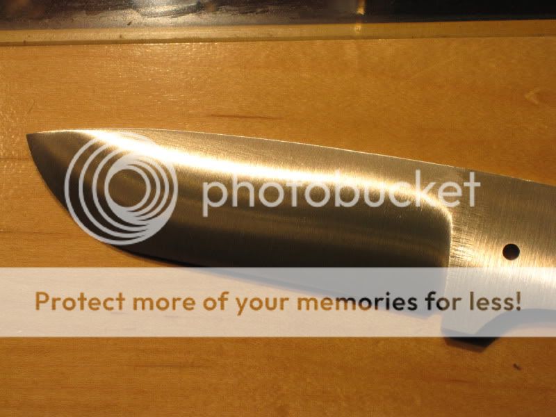

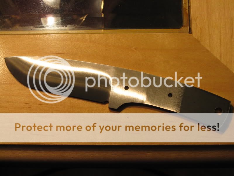

When a CNC machine cuts out a blank knife and does the primary bevel, I assume all the cuts are horizontal. All the flat stock steel I order are cut horizontally. Here's a bad example, but you can see the CNC cutting the knife horiztontally: http://www.youtube.com/watch?v=yoZzuIv6zeE
After the main profile and bevel are cut out, it is then given to someone to get sharpened and put a satin finish on, and that's when you get the vertical lines from a belt grinder. To get rid of all the horizontal lines and achieve that satin finish, you need to work from lower grit to higher grit. If you move up to fast, the finer grit belts cannot cut deep enough to penetrate the deeper lines, meaning you might have not worked that area enough with the lower grit to remove ALL horizontal lines, leaving those fine thin marks behind "under" the polished surface.
Here's an example of a knife I am making. You can see the the horizontal marks from the CNC near the tip, plunge line, and tang. I've had to go back and regrind the whole knife to get rid of it.
